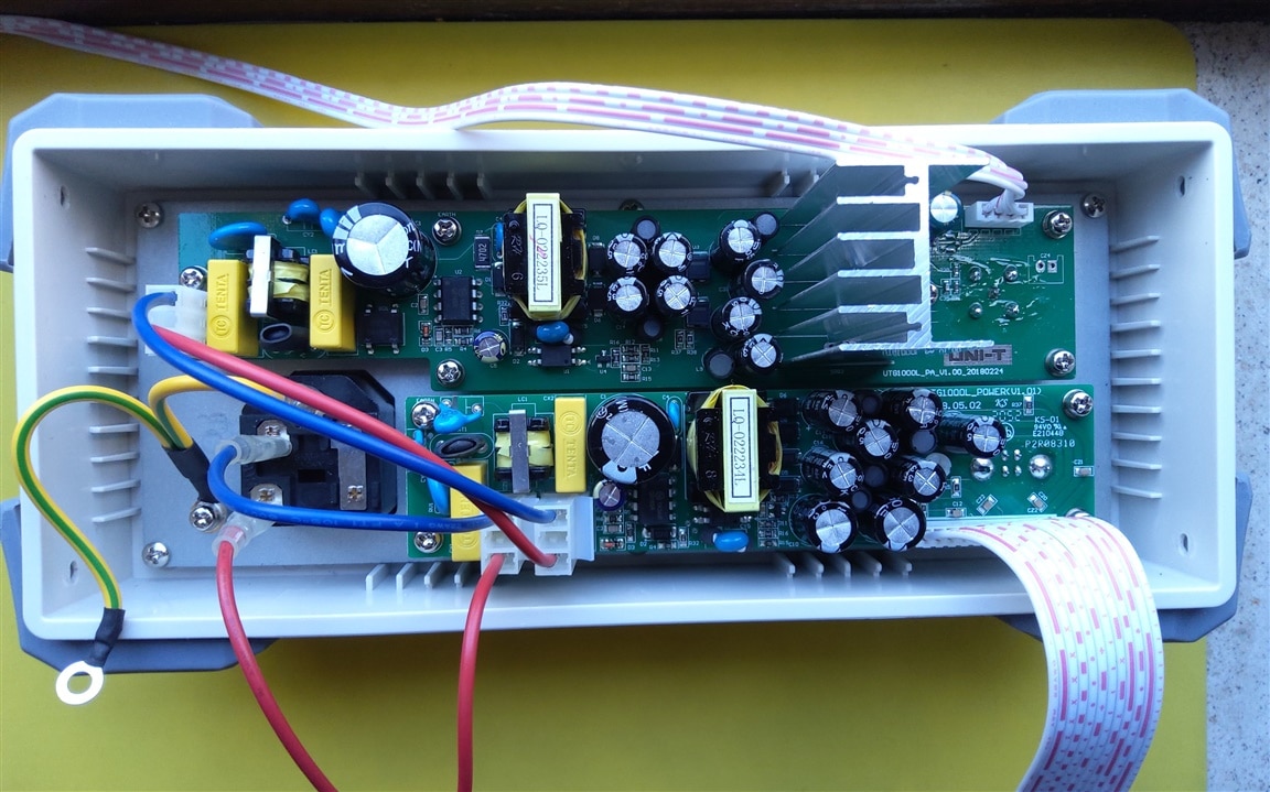

My function generator started to have issues the last days. The keypad is of the gummy-button style, and the up key wasn't behaving properly.
It got stuck each time I pushed it and I had to wiggle it back into position. Time for a second (and more complete than in my first blog) teardown.
Fixing wasn't hard. There was nothing broken, and the button sheet wasn't ripped. I think it got displaced (the up and down keys are the ones you use most, to change frequency, amplitude, ...).
Removing the sheet and carefully putting it back did the job.

    I have a theory of what happens with this model:
    The most used buttons (by me) are the up/down ones. When you adjust frequency, amplitude (all values actually) step by step, these are the to buttons that you use - repeatedly: up 100 Hz, up 100 Hz, up 100 Hz, .... There is no knob, you use the buttons.
    The Up button has the most flex of the whole button rubber contraption, it's near the side, on a corner. So it has the least "rebouncy" real-estate around it. It's also the most floppy button when you take the rubber out of the instrument and flap it around. That the up and down are wider than the rest, also seems to add to the "less strength and recovery" than the other buttons ...

    Errr ... those capacitors make me nervous. But then again, that's what I'd expect from Uni-Trend.
    - Gough
