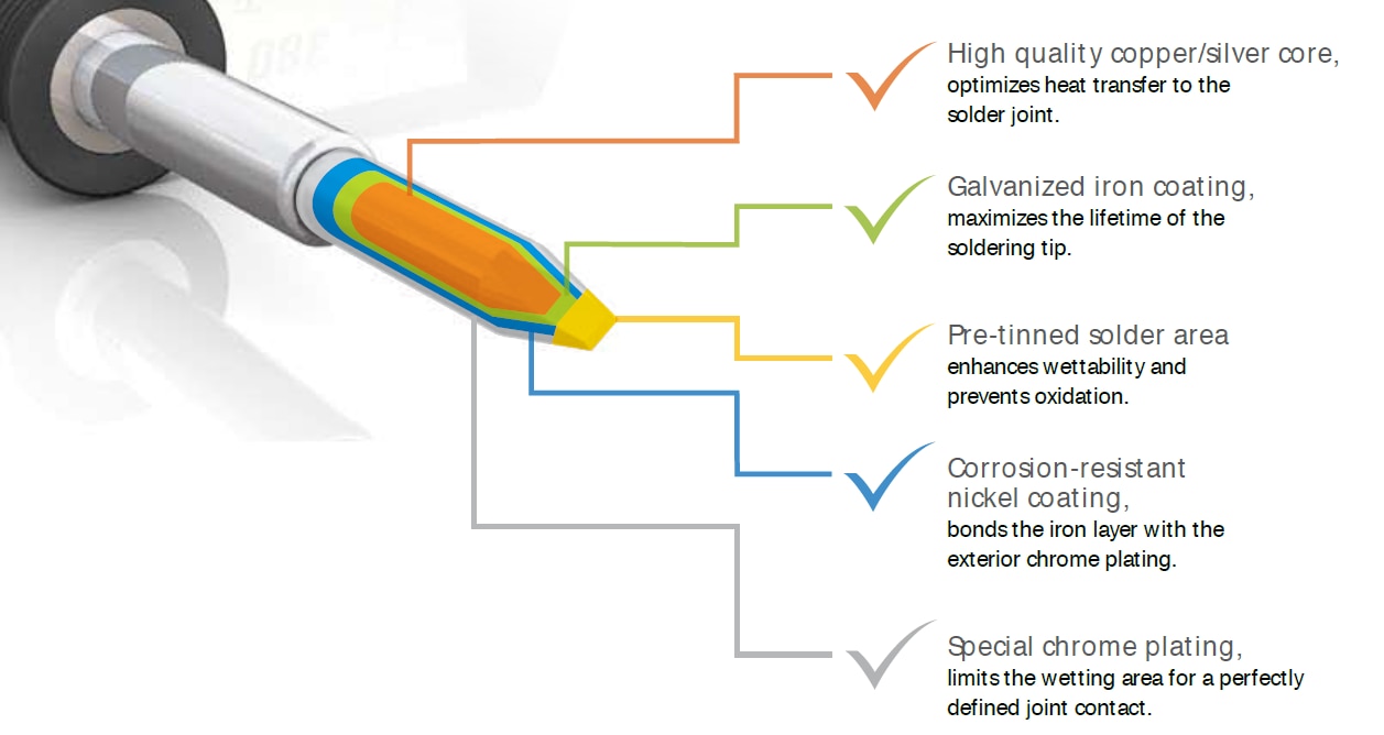

    Quality solder tips are plated with chrome (over the iron plating over the copper core.)
    My understanding is that electrolysis is an effective way to remove chrome from a surface!
    So while you may have removed the thick oxidation, you likely removed the protective chrome layer as well.
    FYI, This is a cross-section I got from Weller.
    It's not clear to me what the "pre-tinned" tip in this case is. However, my assumption is that the layers wrap around to the tip (yellow section).
    FYI, Weller sells a polish bar you can use to scrape oxidation off of a tip in bad condition. (Just make sure the tip is cold when you do!) For a video on tip maintenance, I accelerated the oxidation of a tip. I was able to recover it with the bar. (but I would probably only use it until I got a replacement.) Nice to have when you're in a pinch, but I would instead recommend keeping a back-up tip on-hand!
    dougw over 3 years ago in reply to baldengineer
    My understanding is the solder tinning only sticks to iron so that is what is right at the tip.. Further up, the iron is protected by chromium and nickel but the iron right at the tip is only protected from rusting by solder tinning. Rust happens quickly at high temperature - it eats away the iron and solder doesn't stick to rust, which is why tinning is so important.
    Copper gets heat to the tip, Iron protects the copper from oxidation and wear, solder protects the iron from oxidation. The best refurb method would remove all rust from the iron tip without removing any solid iron.

    The problem with all three of the methods you listed is that they'll take the protecting plating off the tip along with the corrosion. This is bad because then you're almost instantly oxidizing layers that were not meant to be exposed to oxygen, much less oxygen, while heated.
    So sandpaper or steel wool can be helpful as a temporary fix if you have zero other options. But once you use them, consider the tip dead and needing replacement.
