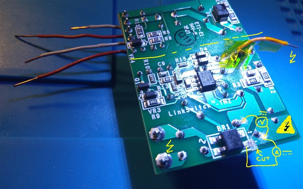

    I may do a little cop-out, a use Power Integraton's wattless meter approach:
    Break DC path just after the rectifier, and before the bulk capacitor. Amp meter over the cut, volt meter over the bulk cap.
    Then improve accuracy by assessing the loss in input protection and rectifier.
    It's documented here: https://www.powerint.cn/sites/default/files/forum/files/PIU-102_MeasuringEfficiency.pdf

    0 Jan Cumps over 2 years ago in reply to Jan Cumps
    This is the plan, halfway executed:

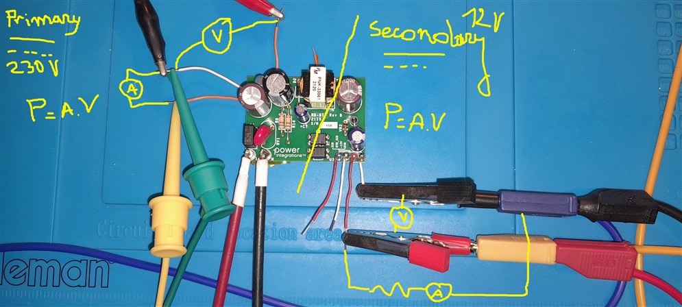

    fully executed Slight smile :
    The efficiencies make sense now. I've not taken in account the rectifier and input protection loss, but extremely close to the data sheet:
    PI data sheet:
    My measurements:
    30 mW standby power
    efficiency at load:
    • 51% at 1%
    • 77% at 10%
    • 81% at 100%
