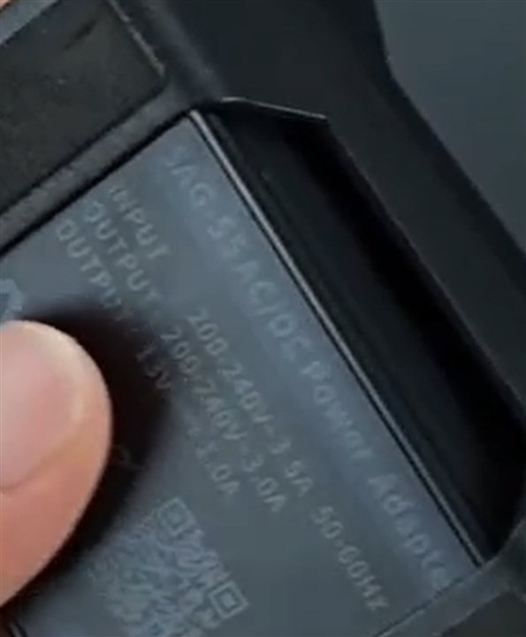

    My concern is that the PSU brick doesn't look big enough for 550W.

    They showed the PSU brick briefly in the video, I zoomed-in, looks like they probably pass-through the mains, but have a low-voltage output too.

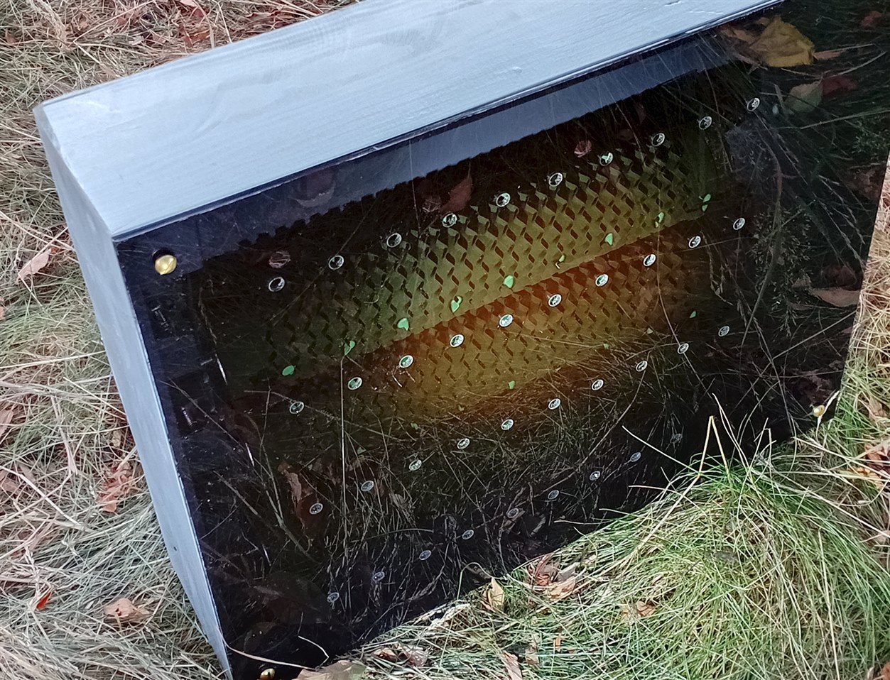

    Regarding loads, I've been building this beast, 900W! : ) It's three 1-ohm resistors (they are over a foot long : ) from AliExpress, which I still need to wire up in parallel, I don't have the wire or tubular copper lugs yet, I need to buy those. The wood enclosure, along with the scenic dried grass, is all just kindling if it goes up in flames : )
    I'm going to wire a small panel voltmeter to it too, so I can quickly see what the power approximately is.
    I'm only building it for one quick purpose (test a 12V 600W power supply) and will probably have a desk fan running nearby (there are holes on the rear wood back, directly behind the resistors, so that the air hopefully runs around the surface of the resistors), and only power it up for a few seconds at a time.. with the perspex cover removed!
    There's space for a fourth 1-ohm resistor in the enclosure, so if I purchase that, then I could re-wire it into a 4-ohm speaker simulator, but I doubt I'll ever need such extreme capability. I might just donate it to an amateur radio group after I've finished with it, since it will be useful for double-checking that power supplies are functioning before attaching to expensive radio transceivers.

    Hehe, I'll be on the news for accidentally burning down a town or village in the direction of my fan : )
    There is a famous 100-year-old case (famous because it established some liability that didn't exist before that case), where there was a ship with huge logs/planks of wood that would occasionally fall, and fuel leaks frequently. Apparently, it's extremely unlikely to cause a fire with just planks and fuel, so they did nothing about it! But Murphy's law did strike, and the entire ship exploded.

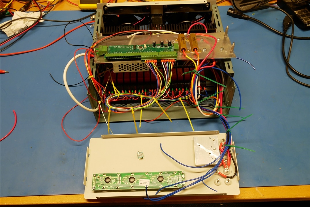

    I built a passive load a few years ago. It was mainly intended for audio amplifier power supplies but its done a few other things as well.
    10 x 50W 100R resistors switched by relays and 10/22/47 switched in by a big MOSFET. (The 10R is a 200W resistor but not heat-sunk enough for continuous operation).
    The bank of 100R resistors is well enough cooled for continuous operation at 400W.
    I built this because of my uncertainty about the interaction between active loads and the DUT when doing high power transient testing - but its far less convenient to use and limited in the load steps it can apply.
    So far it hasn't started any fires. Slight smile

    That looks superb. Quite a significant difference in construction quality compared to the wood effort : ) And that steel chassis looks excellent!

    I regretted the small size once I was committed to squeezing it all in !
    The box came from RS.
