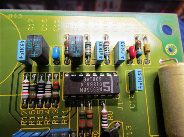

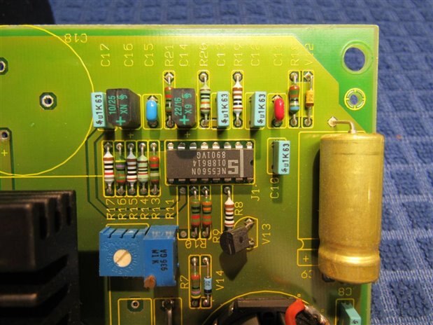

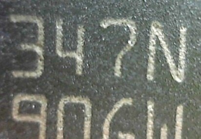

Recently I posted a couple of pictures that fell short of being the quality that I was looking for. mcb1 was kind enough to send me some excellent tips on camera settings. I thought it might be helpful to everyone if we all share some of the tips and techniques that we use to get good quality pictures of our projects and builds. This will hopefully get the conversation going and we can add to it as ideas and techniques begin to flow back and forth.
Here is my first Tip:

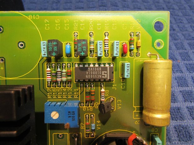

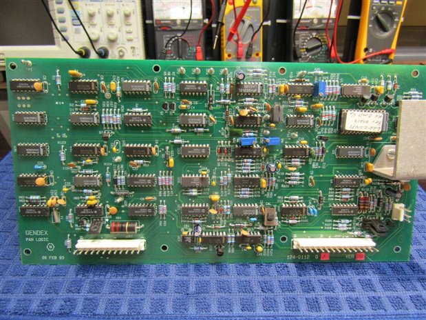

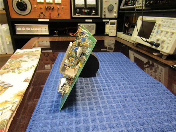

When I try to take a picture of a circuit board that is layed out flat on my bench I have difficulty with shadows frm my body and camera. I also experience difficulty eliminating flare on the circuit board from the over head lights. By propping the circuit board at an angle to the lighting it is much easier to avoid the shadows and the flare. In these pictures I am using a hockey puck to prop the board up.
These pictures were shot at f3.5  1/30th of a second exposure.
    balearicdynamics over 10 years ago +3
    Hi John! Good idea to open this discussion. Really. To avoid shades and get the best field depth also a lens ring light (neon or cold LED ring) is a good choice to reach a good illumination, reduce the…

    D_Hersey over 10 years ago +2
    Sometimes there is a lot of high-albedo stuff on a circuit board You might experiment with a polarizing filter, linear or circular
    I use a copy-stand. I illuminate with white LEDs and UV LEDs, but I could use tungsten.
    mcb1 over 10 years ago
    John and others.
    There is no magic bullet for bright spots due to lighting.
    A polarising filter might help only if the light is single direction to start with.
    When I worked at the Photography studio the copy setup used two light sources at 45 deg with polarising filters and a filter on the lens to eliminate the reflections, which is a little bit OTT for home use.
    Subject placement
    For most of my images I use natural light coming in from a window behind and mostly above the subject.
    The window is on the south side (light is from the north in our end of the world) and it is often later in the day, so it is much less intense and is not direct.
    I place a white card or white surface to bounce light back onto the subject.
    One of my reflectors is a A4 paper that has been laminated and it works well since it can be bent.
    This lighting works better than the studio lights as there are no bright spots and you can easily see the results.
    You can easily check the light by clenching your fist and pointing your knuckles at the light source. The shadow on your palm will give an indication of where the light is coming from and how bad the shadow will be.
    Colour
    The light colour (Flash, Tungsten, LED, Florescent v natural) can be corrected in the camera and often the colour needs tweaking slightly to enhance the image, so you can use whatever you have as long as you understand the correction required.
    My Metz flashes tend to be blue, and both the internal flash and studio flash are white, so know your equipment and the effects is more important than using xyz.
    Depth of Field
    I shoot at the lowest aperture (highest F stop) the lens has which usually dictates a shutter speed of 1-2secs.
    Rather than the close-up rings I use an extension tube between the lens and body, which gives the magnification while keeping the lens away from the subject.
    There is software that will allow stacking of images to improve the dof, but you need to take multiple images at different focus points.
    At these speeds and dof it is important to use a cable/remote shutter release. If you can't then use the self timer and cover the eyepiece to prevent stray light from entering and fogging the photo.
    RAW v JPG
    All my photography is done in raw format which means a 24mB raw image.
    Raw format allows some manipulation before it gets converted to a jpg, but the most important part of the manipulation is to sharpen the image which brings the three individual sensors into line.
    Many of the cameras do a reasonable job of taking what they see and converting it, but it is a compromise and once it is a jpg anything you do is subtracting from the image.
    Because of the small size of 35mm format, images need to fill the frame (something you don't need to worry about with a 6x6 camera) so get as close as you can.
    Post manipulation
    There are lots of things that can be done after the image is taken.
    I've removed scratches or annoying bits, however if the detail is not there, you can't easily recreate it using software.
    From experience it is quicker to do it in-camera rather than post image, so download the image and check it on your computer while the subject is still setup and go back and reshoot if you're not happy.
    Hopefully these insights help someone.
