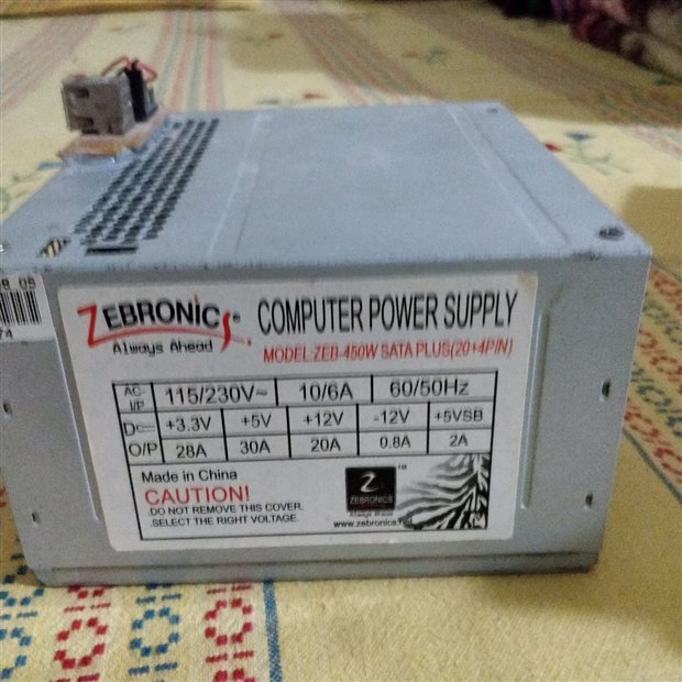

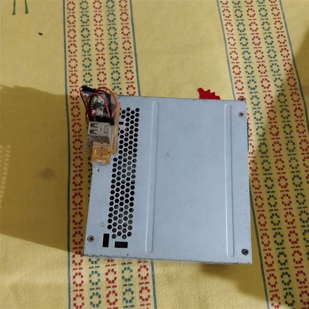

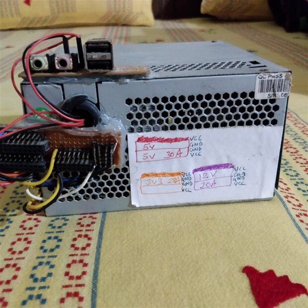

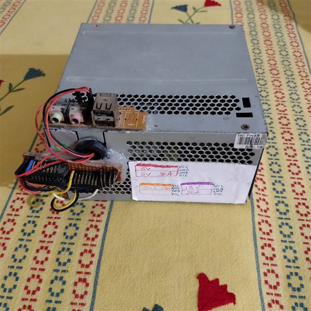

Hey guys , Just wanna share the Cheep Power supply I made using an old SMPS laying around,
Can anyone suggest some more hacking to it image Or may some of community members might have made one themselves, care to share image

    Jan Cumps over 8 years ago
    How does it behave with very low currents? Some of these computer PSUs shut down when there's no minimal (for them) current flowing.

    I use similar (cheap) ATX PSUs as power supplies, and none of the units I've used shut down at low/no load.

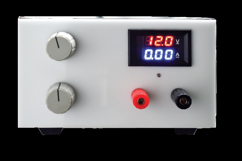

    I followed jw0752 blogs
    Using the Coarse + Fine Control circuit in my new Dual Bench Supply
    Oh No! Not another  #@&%# Power Supply
    and since it was so easy to follow ... I made did this one.
    (BTW John it's been very handy)

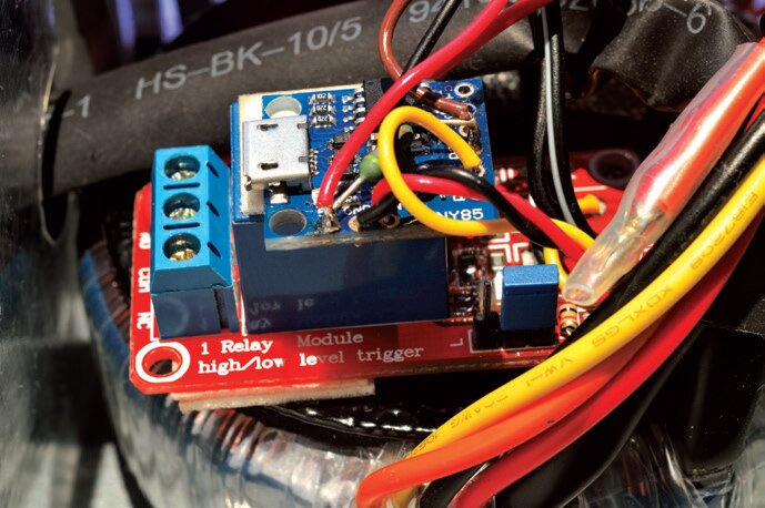

    I used the case from a computer supply
    The cooling fan is controlled by a Digispark clone reading a DS8B20 temperature sensor and switching the relay.
    Dallas 18B20 poked into the cooling fins behind the output control transistor
    Schematic overview.
    Note the current meter goes in the negative lead to allow much greater voltages to be monitored.
