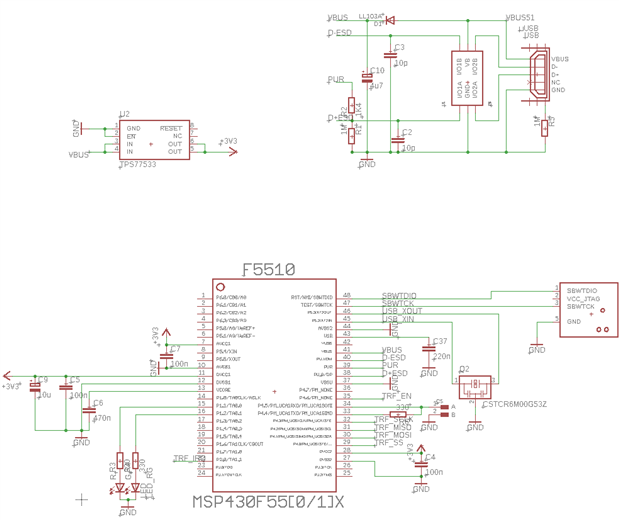

    I found that when making my own boards that the schematics of the Launchpad was a good starting point.That and the datasheet will give you all you need. Obviously your board can be greatly simplified by leaving off everything related to the debugging side (Labelled eZ-FET lite in this schematic). You will be able to use a Launchpad to program and debug your own board if you have a JTAG/SBW header in place. I'm happy to share my minimal MSP430F5510 design if you feel that would help. It's definitely worth getting everything working on a Launchpad before worrying about a custom board though.

    This is my minimal F5510 implementation. A regulator to get the 5V USB down to 3.3V, some transient suppression on the USB lines, some passives and a programming header. (I had more stuff for a NFC reader but have left those out.)

    techtest over 7 years ago in reply to Fred27
    Thank you so much for this amazing post.
    Apologies for not getting back earlier, I was with family since middle Dec til last week, and only now get back to this project.
    The faulty device has been exchanged for a working one (tested in CSS with MSP430F55xx_adc_01.c).
    Thanks for the hint re Energia/CSS, and the great tips how to make my own board.
    It might be necessary/better to ask an expert to do it, since it might take me to much time and still not yield the result needed.
    Yes, the USB is for data transfer to mobile and to draw power from it (for simplicity/convenience avoids battery, cables, wifi/bluetooth setup complications).
    Again, many thanks for your very helpful post!
