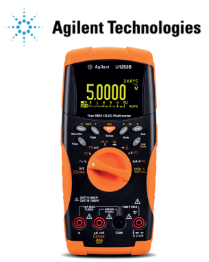

The Agilent U1250 Series handheld digital multimeters (DMMs) exceed your expectations by delivering powerful features and performance that meet your toughest requirements and applications. The series latest multimeters, the offering capabilities and functions you need.
  • Do more with just one instrument
The basic model, U1251BU1251B, expands your capabilities beyond typical DMM measurements to include data logging. The U1252BU1252B starts with the same foundation, and then adds a 20-MHz frequency counter and programmable squarewave generator, so you’d be able to perform more tests conveniently with one tool. What’s more: both models come bundled with a complete set of accessories to equip you right from the start at no extra cost.
  • Find problems quickly
Troubleshooting can be tricky, especially when you’re dealing with elusive problems. With the U1250 Series’data logging capability, you can ensure that every reading gets recorded manually or at intervals you specify. Better yet: you can have virtually unlimited data logging saves when you connect any of the U1250 Series DMM to a PC with the optional IR-to-USB cable.
  • Uncompromising ruggedness and safety
The U1250 Series DMMs are housed in robust overmold enclosures, rated at CAT III 1000 V and CAT IV 600 V and operate over a wide temperature range of –20 °C to +55 °C. Each DMM also include a 30 kA high energy fuse to further protect you against violent fuse failures during high-current measurements. Built tough and certifi ed to stringent industrial standards, the U1250 DMM is what you need to face the demands of everyday tasks.
Key Applications: Automated test applications, ATE systems in R&D, design validation, and manufacturing.
