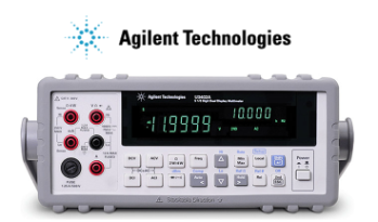

The U3400U3400 Series digital multimeters (DMMs) come with functions vital for your everyday measurements: DC, AC and AC+ DC voltage and current, 2- and 4-wire resistance, frequency, continuity and diode tests. Math functions, such as dBm, Min/Max, Relative, Compare, Hold and Percentage are also available to ease your measurement analysis. Not only are the U3400U3400 Series built robust for lasting reliability over the long haul, these DMMs also ensure dependable measurements with up to 0.012% basic DCV accuracy.
Dual display on the U3400U3400 Series lets you view two parameters simultaneously as you measure, and further enhances your troubleshooting tasks. For example, the ability to see both AC voltage and frequency simultaneously would help you to measure the frequency response of amplifier circuits more efficiently and effectively.
Up to three measurement speeds are available on the U3402AU3402A: Slow, Medium and Fast. This means greater flexibility in catering to different testing needs: a faster measurement speed at lower resolution or a higher resolution at slower measurement speed.
Key Applications: Automated test applications, ATE systems in R&D, design validation, and manufacturing.
