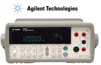

The Agilent Technologies 34405A34405A digital multimeter has all the tools you need at an affordable price. It provides a broad range of features and easurement functions such as DC voltage, DC current, true- RMS AC voltage and AC current, 2-wire resistance, frequency, diode test and continuity which are designed to meet general industrial needs. Furthermore, it can measure temperature ranging from -80oC to 150oC. The true value is more evident with its capability to measure capacitance ranging from 1000 pF to 10000 mF. Agilent 34405A34405A also improves efficiency and accuracy with its six built-in math operations: Null, dBm, dB, MinMax, Limit and Hold.
Quick Connection to the PC with USB 2.0 Interface
For those with a need to control and take preset measurements with a PC, the built-in USB 2.0 interface provides an easy and robust connection between the PC and DMM. The USB interface connects directly to the PC host and works seamlessly with Agilent Connectivity software and can be controlled remotely via  industry standard SCPI commands or through DMM Intuilink Connectivity software.
Bright Display, Fast Reading Speed and Configuration Storage
When high throughput and productivity are the priority, Agilent 34405A34405A VFD dual display feature allows users to take more than one measurement and display them simultaneously on the front panel. For speed critical applications, Agilent 34405A can take up to 19 readings/sec at 4.5 digits resolution directly to the PC. In addition, the user can configure and store complete instrument setups and recall them at anytime from any of the four built-in storing states
Rugged and Reliable
The 34405A34405A is designed and tested according to major Safety and Regulatory Standards. In addition, the shock absorbing bumpers is designed to prevent physical damage from your day-to-day use.
Key Applications: Automated test applications, ATE systems in R&D, design validation, and manufacturing.
