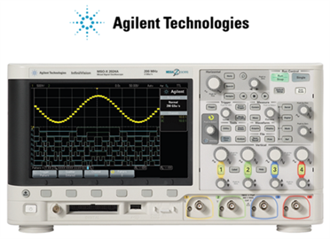

Agilent Technologies  InfiniiVision X-Series oscilloscopes engineered to deliver value, functionality and flexibility at prices that fit into your existing budgets. Whether you are looking for a basic entry-level oscilloscope or a more sophisticated model to get your job done, you want the most you can get for your money. The full line of InfiniiVision X-Series oscilloscopes – 30 models – ensure that you get exactly what you need today with room to grow in the future.
The InfiniiVision 2000 X- Series offers bandwidths from 70 MHz to 200 MHz and boasts the fastest waveform update rate in its class for superior viewing of signal detail and capture of infrequent events. First-in-class optional 8-channel mixed-signal oscilloscope (MSO) capability and the industry's only optional integrated function generator offer more capabilities to engineers and educators with highly constrained equipment budgets..
Agilent InfiniiVision X-Series oscilloscopes offer compelling benefits for engineers and technicians to:
  • See more of the signal more of the time: InfiniiVision X-Series models provide the fastest update rates in their class -- up to 1,000,000 waveforms per second -- with MegaZoom IV technology that also minimizes blind time and maintains responsiveness with deep memory enabled. All InfiniiVision X-Series models are equipped with an 8.5-inch WVGA display, which offers twice the viewing area of other popular scopes. Yet they weigh only 4 pounds and conserve bench space with a small footprint, about 15 inches wide and less than 6 inches deep.
  • Do more with the power of four instruments in one: In addition to best-in-class oscilloscope performance, InfiniiVision X-Series oscilloscopes offer optional integrated MSO capability for time-aligned digital and analog signal viewing, an optional integrated function generator, and optional hardware-accelerated serial protocol analysis (on the 3000 X-Series models only).
  • Get more investment protection with upgrade options: The InfiniiVision X-Series is the only fully upgradable (including bandwidth) scope in its class so engineers and technicians can purchase what they need today and add capability as their performance needs evolve. Optional measurement software packages add functionality, either at time of purchase or as needs arise:
  • Segmented memory for analysis of laser pulses, radar bursts and serial packets;
  • Hardware-accelerated mask testing to quickly perform pass/fail analysis using known good waveforms; and
Key Applications: Design and Debug, Education and Training, Manufacturing Test and Quality Control, Service and Repair.

The Agilent InfiniiVision 2000 X- Series oscilloscopes deliver these features:
  • 70 MHz, 100 MHz, and 200 MHz bandwidth models.
  • 2 and 4 channel digital storage oscilloscope (DSO) models.
  • 2+8 channel and 4+8 channel mixed-signal oscilloscope (MSO) models.
  • An MSO lets you debug your mixed- signal designs using analog signals and tightly correlated digital signals simultaneously. The 8 digital channels have a 1 GSa/s sample rate, with a 50 MHz toggle rate.
  • 8.5 inch WVGA display.
  • Interleaved 2 GSa/s or non- interleaved 1 GSa/s sample rate.
  • Interleaved 100 Kpts or non- interleaved 50 Kpts MegaZoom IV memory for the fastest waveform update rates, uncompromised.
  • All knobs are pushable for making quick selections.
  • Trigger types: edge, pulse width, pattern, and video.
  • Math waveforms: add, subtract, multiply, and FFT.
  • Reference waveforms (2) for comparing with other channel or math waveforms.
  • Many built- in measurements.
  • Built- in license- enabled waveform generator with: sine, square, ramp, pulse, DC, noise.
  • USB ports make printing, saving and sharing data easy.
  • Optional LAN/VGA module for connecting to a network and displaying the screen on a different monitor.
  • Optional GPIB module.
  • A Quick Help system is built into the oscilloscope. Press and hold any key to display Quick Help.
