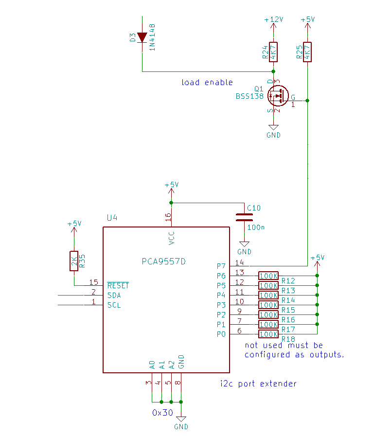

This blog documents focuses on the functionality of the Input Enable block of the electronic load that Robert Peter Oakes, jc2048 and Jan Cumps are designing.
We're using an i²c port extender to drive this functionality. It will be mostly focusing on the firmware but let's also look at the electronics involved.
The circuit disables the output by pulling the signal that sets the load's current to ground. The switch that pulls it to ground is a FET.
The interface between that FET and the microcontroller is an i²c controlled port extender. We're using its P7 as the driver of that switch FET.
We'll have to create an RTOS task that puts all pins of the extender in correct mode. Then it has to listen and react on messages that indicate whether the input has to be on or off.
At the moment the task is only focusing on the single output pin of the port extender that we're using.
In the future this task may change into a more generic one that can set any of the available pin's function, then read and write as appropriate.
We don't have to worry about that now. Nothing here prevents to make that generalisation later - we don't need it now.

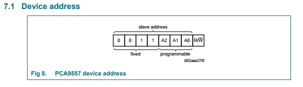

I'm using the NXP datasheet (PCA9557 is available from TI and NXP the one on my prototype is from NXP).
The address of our chip is determined by the pins A0 - A3:
Because we've tied all of them to ground, our 7-bit address is 0x18.

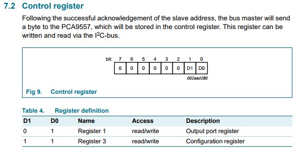

To have the right setup and give the right commands, we need to send instructions to two control registers.

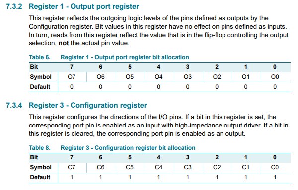

Here are the relevant registers for setting the pin directions and setting an output value:
Our first communication will set all registers to output and drive them all high. That's going to be the initial state for our application.
We'll have to submit 2 times 2 bytes at initialisation, after setting the address:
The first time to set the direction.
  • address + ~W
  • 0x01 (output port register)
  • 0xFF (all values high)
The second time we enable all as outputs.
  • address + ~W
  • 0x03 (configuration register)
  • 0x00 (all as output)
Then, during operation, when setting and resetting the P7 of the IC, we have to flip the highest bit in the output port register:
  • address + ~W
  • if enable: 0x3F; if disable 0xFF (we are keeping all other pins high because nothing is happening with them in the current implementation of the load).

    Measurements without initialisation. The switch FET Q1 gate is 5 V and the FET is pulling drain to ground. The load's set signal (left of D2, it happens to be 11.5 V but could be any driving voltage that…

    Jan Cumps over 8 years ago
    The load's set signal (left of D2, it happens to be 11.5 V but could be any driving voltage that the load sends to the output power FET) will never make it to the power FET because switching FET Q1 overrides it.
    Next steps is to control P7 of the extender and see if this whole setup works. Again, that's an exercise in i²c more than an electronics thing.
