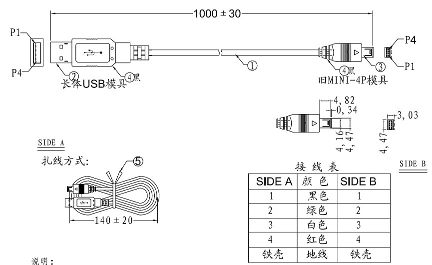

3. I want to  connect the thermometer to LabView, do you have a LabView Library or is
  pls be advised  to use visa
USB cable details, as shown below.
imageUT325 UT320 sereis Operation guide .pdf
