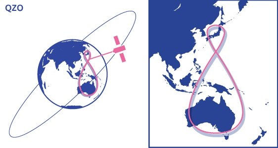

By 2018 a centimeter-resolution positioning system is scheduled to be in operation covering Japan and locations at the same longitude.  The system will augment the US GPS system.
The satellites will be in geosynchronous (not geostationary) orbit that will cause them to trace a figure eight in the sky over Japan.
The high elevation in the sky increases the number of satellites that will have a direct path to receivers in Japan’s densely populated cities.
