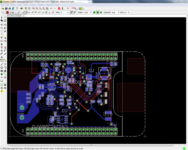

Still under construction...
I'm still not decided about a kernel mod for additional power management support,
I kept a place for a small 430g in order to manage the charging options but maybe is not necessary.
The coil will be a Vishay IWAS-4832FF-50 and the battery a 1000mAh LiIon. All stacked.

    Hi Danteo,
    saw that you are using the RX coil from Vishay. Have you also had a look at the 760308201
    http://de.farnell.com/wurth-elektronik/760308201/wireless-power-charging-spule-10uh/dp/2114372?in_merch=New%20Products
    It is a more compact design
    regards
  • danteo
    danteo over 13 years ago in reply to lfa555
    Thank you Lars, I choose the Vishay but I will test also the Wuerth coils.
    Dan
