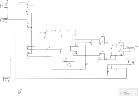

Hi all. Newish here. Never posted before so sorry if this is wrong section. Not used to this type of forum layout.
I have an old gaming headset.
http://www.fatality.com.br/ecommerce_site/arquivos2600/arquivos/1338956732_3.jpg
They are really nice but come with crap cables to plug into a 3.5mm jack.
So what I want to do is make them into a wireless bluetooth headset.
I want to be able to use the mic though so need to upload a channel and download two for left and right speakers.
I found this KC-5190 "Bluetooth Audio Hi Power Module" at http://kcwirefree.com/audio.html
So as you can see,,, bit small. Good for fitting into the headset. Bad for wiring up as it is made to be put onto a PCB and not cabled up.
The chip does everything I need. It also allows you to have it charge a battery from either a 4-6v line or via the USB lines. (IDK the tech terms for the copper bits.. )
So perfect chip in every way but the size.
I guess I could get someone to print me a breakout board to fit what I need?
Anyone got any other "modules" that would be suitable for what I need?
Thank you.

    Jackster over 13 years ago in reply to e14 Contributor
    Worked out in the end.
    Used the KCwirefree part and it does a good job.
    Though there are a few problems still and I have not had a chance to fix them this is still the best way I could get both speakers and mic working via bluetooth.
    e14 Contributor over 13 years ago in reply to Jackster
    i checked out that part the kc5190 and i am wondering if you could share how you setup the master slave? i am trying to add bluetooth to this Schem.image
