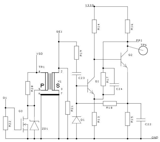

  • michaelkellett
    0 michaelkellett over 6 years ago in reply to neuromodulator
    Here is a circuit to drive a 40kHz air transducer for a reversing system. It's about as cheap and simple as it gets. The RX amplifier is shown too.
    A depth sounder (cheap) works the same way.
    Q3 is driven by a signal from a uP timer to give  burst of pulses at the operating frequency of the transducer.
    The transformer is a 1:10 and designed so that its inductance tunes the piezo element to the operating frequency.
    The piezo transducer is connected between SE1 and GND.
    D1 protects the transistor from the huge signal on the transformer secondary.
    VSD was 5V and we got about 50V pk-pk at SE1.
    There was a 40kHz bandpass filter connected to PR1 and the output of that went to an ADC port on a micro.
    For communications you could start by trying the modulation and encoding schemes used by IR remote controllers.
    One of these uses 0.6ms on/0.6ms off for 0 and 1.2ms on/0.6ms off for 1, this will give bursts of at least 24 cycles (at 40kHz) which should work quite well.
