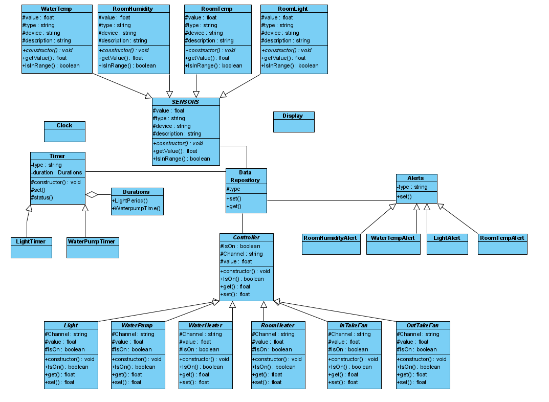

  • Class Diagram
Here is the class diagram for the software.

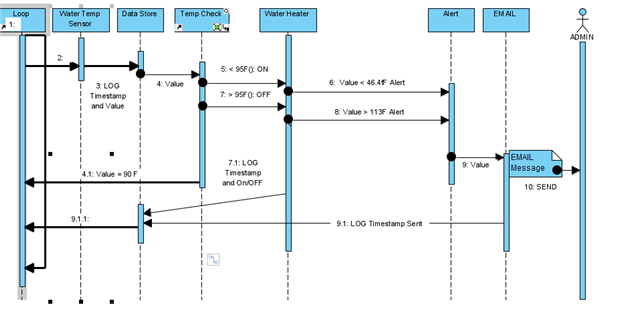

    • Maintaining an ideal growing temperature of the water
      • Studies have found that the ideal temperature is 35C (95F) and should be maintained Between 8C (46.4F) AND  45C (113F)
      • Log the Datetime and Value to the data Repository.
      • to maintain an ideal water temperature for growing spirulina, the following flow will be used:

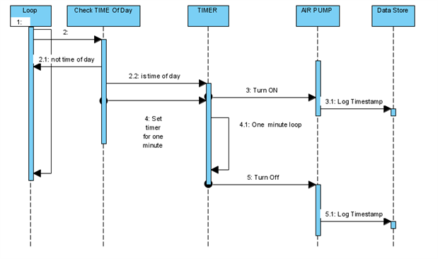

    • Maintain Oxidization in the water
      • To maintain an ideal Oxidation level in the tank, an air pump will be used.
      • The Air Pump will be Turned On 1 minute 3 times a day
      • Log the datetime and value ON/OFF to the Repository.
      • To maintain an ideal Oxidation level for growing spirulina, the following flow will be used:
          • image

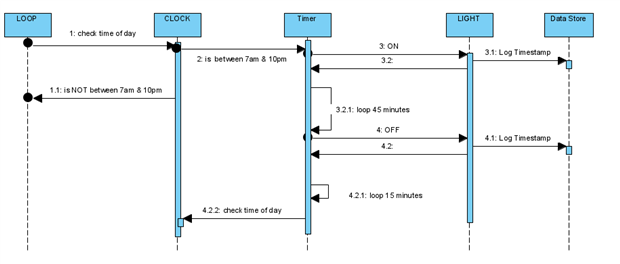

    • Maintain the right Amount of light exposure
      • Studies show, that to improve the growth rate:
        • a light can be turned ON every hour for 45 minutes and OFF for 15 minutes
        • From 7am to 10pm.
      • A Lamp will will be turned off and on, at these times.
      • To maintain the right amount of light exposure for growing spirulina, the following flow will be used:
            • image

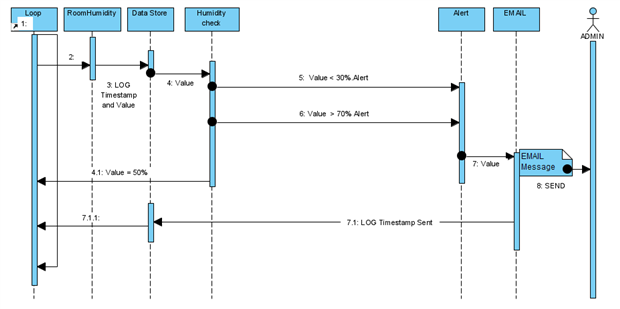

      • Keep the Humidity at 50%
        • Try to keep the humidity around 50% and send an alert if it goes DOWN or UP by 20%
            • image

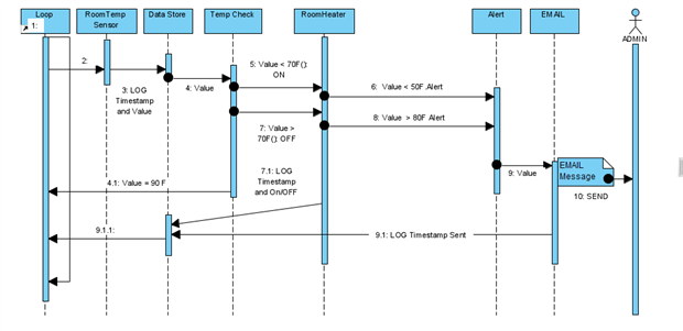

      • Keep the Temperature at 70F degrees
        • Try to keep the temperature at 70F degrees and send an alert if it goes down or up by 20F degrees.
        • if the temperature is less than 70F, turn ON the room heater
        • if the temperature is greater than 70F, turn OFF the room Heater
        • If the temperature is > 80F  and the heater is ON,  Turn OFF the Heater and send an Alert
        • If the temperature is < 50F  and the Heater is OFF, Turn ON the Heater and send an Alert
        • Log on/off commands and Email sent to the Data store.
          • The following flow will be used:
            • image

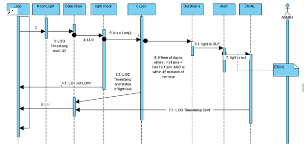

      • Make sure the light is operational.
        • Use the LUX sensor to monitor the Light sensitivity by capturing & storing, the values over the operation of the software.
        • if the lux level is low and  within the timeframe of 7am to 10pm.and it's within 45 minutes of the hour, then send an alert that the light should be ON
              • image

    I really dig the nice diagrams that you used to describe the operation of the software!
  • skruglewicz
    skruglewicz over 5 years ago in reply to ajcc +1
    Thanks ajcc Those are UML sequence diagrams. I tried the trial version of this software https://www.visual-paradigm.com/download/ Cleck it put Steve K
