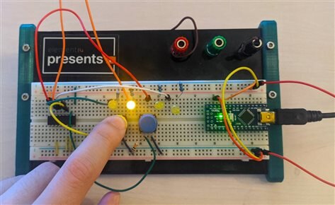

Test circuit
     On the picture above you can see how everything should be connected. The LED-s above are connected only to the first 4 channels, so we can get away by using only the least 2 significant bits, the A & B. Though, as I've mentioned above, you should then connect C to the ground, that's why you can see I have a pull down resistor on all of the switches. I'll now wire this up and show you a short demonstration for this.
     In this picture, you can see everything connected like on the schematic above, except the C input on the multiplexer which I tied to ground since I'm only working with 4 LED-s. The Arduino is on the perfboard because I will be using it as a 5V power source for this demonstration.
Test
     On the pictures above we can see the first 2 states. If nothing is pressed we will have the channel zero active - connected to our COM IN/OUT which is connected to 5V which is why are first LED is shining. If we press the first button, we can see the second LED light up, that is channel 1.
     On these 2 pictures we can see the last 2 states. When only the second button is pressed we have the third LED shining, and when we press both buttons at the same time we have the fourth LED shining. It's a really simple concept which can be used and is used often to save a lot of pins. While I know that a lot of people have played around with this already, I thought it would be a good idea to share a small demonstration like this on how to use something like this, because it's really easy to use and you can get a lot of good results. Here is a short video for this test.
     That would be all about this part of the circuit. You can now see how I plan on using this in my project. The COM IN/PUT pin will be connected to the connector that goes to the tool on the robot, while the CH0, CH1, CH2 pins for example are connected to an interrupt pin, PWM capable pin and an analog pin. Then I just connect A & B to 2 random digital pins and I can control like that to what the tool is connected.

     The code consists of mostly function that I've written which are designed to do different things, from turning on/off the pump, to homing the robot on the rails. There will be more function added than this in the future which will take into account I2C communication, another thing I want to do is convert the stepper steps into cm which is done easily enough. Main programming and control part will be done by the Raspberry, the point of the Arduino in the module is to listen to the commands from the Raspberry and execute them. With the code done, let's get to the fun part!

     As I've already mentioned above, there are a couple of things I want to test out to know that everything is working as supposed to. I will show the 4 tests I conducted, the first one being to see if the servos are moving as they should, where one is getting it's data over the multiplexer, the second test will be activating the pump over our relay circuit, the third test will be letting are astronaut going from one end of rails to the other and finally combining all of those at once. These will be simple sequential tasks, but using a timer can go a long way with this module if needed.
1. Test --- Servo & servo over multiplexer
2. Test --- Water pump
3. Test --- End to end on rails
4. Test --- Combined test

Another module wrapped up and 1 more blog to hit 10 blogs! Everything works as expected and I'm pleased with that, it's a good thing that I've done the research and fixes on the stepper driver prior to making this module, because I don't have to go and modify this module a lot. As of writing this blog, there are only a couple of days left until the deadline, so, once again, off to the races to makes this work! All of the relevant links for this competition, link to the next and previous blog as well as my GitHub where I'm uploading all of the models can be found underneath. Thanks for reading the blog, hope you liked it and found it interesting!
