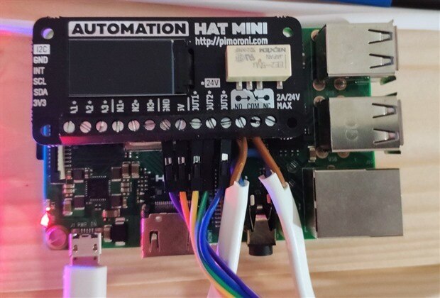

This is connected to a Raspberry PI 3B+ with the Automation HAT MINI from the KIT, that's connected to the water and air pump and the lights.
Software
The "server" is a Python script that's running a XMLRPC server to accept connections from the client (or clients if it were the case).
Very briefly, the script creates a threaded XMLRPC server, allowing it to accept multiple connections simultaneously, not locking.
By default, a server accepts a connection and while processing it, other possible connections are refused.
It defines several functions and register them to the server. The functions will turn on or off the several peripherals wired to the Automation HAT MINI.

Explaining the code
lines 1 to 15 import the several libraries needed for the script to work.
First two lines import what's needed to create a threaded XMLRPC Server
from xmlrpc.server import SimpleXMLRPCServer
from socketserver import ThreadingMixIn
We then import datetime and time . We import threading to create some threads .
We next import the automationhat python library. We then import the logging and telegram libraries, as well the systemd libraries.
The configParser is imported to be able to import a config file.
Next, we import the libraries from PIL, such as Image, ImageFont and ImageDraw.
Next, we import ST7735 to be able to work with the LCD of the HAT.  We import the Roboto font, also for the LCD.
from PIL import Image, ImageFont, ImageDraw
import ST7735 as ST7735
from fonts.ttf import Roboto as UserFont
Lines 18 to 25 create the LCD object, initializing some values specific for this LCD.

def removeText(element):
    disp.set_backlight(1)
    rectElements =  [30, 45, 60]
    del_rectangle = 30
    # draw the rectangle
    draw.rectangle ((130, rectElements[element],
                    130 + del_rectangle,
                    rectElements[element] + 15),
                    (59, 55, 60))
    # the display will be done in the function
    disp.display(image)
    # sleep 5 minutes
    time.sleep(300)
    # reduce brightness of LCD
    disp.set_backlight(0)
    return 0
""" Write text to the LCD
def writeText (element):
    draw.text((130,rectElements[element]), "On", font=font, fill=(156,170,171))
    disp.display(image)
    time.sleep(300)
    return 0
Because I'm afraid of burning the LCD if I left it on all the time, I wanted to display the status of the pumps/lights and turn the display off after a while - 10 minutes looks like perfect - I've created two threads that will call the functions above.
Why threads ?
Because I use time.sleep, I need the script not to block while waiting 10 minutes and be able to do multiple tasks at the same time. Threads was my solution.
# defining the threads
def tWriteText(element):
    log.info ("Thread to write text")
    twt = threading.Thread(target = writeText,args=(element,))
    twt.setName ('write text')
    twt.start()
def tRemoveText(element):
    log.info ("Thread to remove text")
    trt = threading.Thread(target = removeText,args=(element,))
    trt.setName ('remove text')
    trt.start()
I don't call the functions writeText, removeText directly - I call the thread functions above and they call the functions.
Line 124 creates a thread called twt that calls the function writeText with element as a function argument. Line 125 defines a name for it and 126 starts the thread.
Line 139 defines a function that will turn off everything. This function only gets called at the start of the script. This ensures that, in case of a power outage, when starting the server again, nothing is working.
def shutalloff():
    # turn off air pump
    automationhat.output[outputAirPump].off()
    # turn off water pump
    automationhat.relay.one.off()
    # turn off lights
    automationhat.output[outputLights].off()
    return 0
Lines 149 and 150 define a font to write text to the LCD . Line 153 initializes the LCD.
font_size = 13
font = ImageFont.truetype(UserFont, font_size)
# Initialise display.
disp.begin()
Line 155 to 158 defines a background image (the one above) and display it in the LCD.
image = Image.open("automation_image_LCD.jpg")
draw = ImageDraw.Draw(image)
# display the background
disp.display(image)
Lines 163 to 174 define a function to send notifications to Telegram.
We define a message, to witch we concatenate the string "AutomationPI: " for me to know what PI sent the notification. It then creates a telegram bot and sends the message.
If Internet is not available, don't exit the script, just don't notify.
def sendMessageTelegram (msg,
        chat_id = config['telegram']['chatId'],
        token = token):
    msg = "AutomationPI: " + msg
    bot = telegram.Bot(token=token)
    try:
        bot.sendMessage(chat_id=chat_id, text=msg)
    except telegram.error.NetworkError:
        # If theres a problem with telegram or internet not available
        # dont let the SpaceVegetablesServer exit with error
        # just dont notify
        pass
turnAirPump (state)
This is the first function related to the Space Vegetables per say.
This function will turn on or off the Air Pump for water oxygenation. Depending on the state argument, we turn the pump on or off.
We start by logging to syslog the operation we're going to to.
Next, a notification to telegram.
After that, we activate/deactivate the output of the air pump.
Finally, we write in the LCD the state of the pump (removeText if turn off or writeText if turn on. - the 1 argument means is the element 1 - see functions above).
After the function declaration, we register this function on the server to make it available to clients.
def turnAirPump(state):
    if state == 1:
        log.info("Turning air pump on")
        sendMessageTelegram ("Activating air pump")
        automationhat.output[outputAirPump].on()
        # display in the LCD
        tWriteText(1)
    else:
        log.info ("Turn air pump off")
        sendMessageTelegram ("Turning off air pump")
        tRemoveText(1)
    return 0
s.register_function(turnAirPump)
turnWaterPump(state)
the same above, but for the water pump.
Instead of a output, the water pump is connected to the relay of the automation HAT.
def turnWaterPump(state):
    if state == 1:
        # to OSD
        log.info("Turning water pump on")
        sendMessageTelegram ("Activating water pump")
        automationhat.relay.one.on()
        tWriteText(2)
    else:
        # to OSD
        log.info("Turn water pump off")
        sendMessageTelegram ("Stoping water pump")
        tRemoveText(2)
    return 0
s.register_function(turnWaterPump)
turnLights(state)
This is the function that turns the lights on or off. It's exactly like the ones above.
def turnLights(state):
    if state == 1:
        # to OSD
        log.info("Turn lights on")
        sendMessageTelegram ("Activating lights")
        automationhat.output[outputLights].on()
        # display on the LCD
        tWriteText(0)
    else:
        # to OSD
        log.info("Turn lights off")
        sendMessageTelegram ("Stopping lights")
        tRemoveText(0)
    return 0
s.register_function(turnLights)
Line 244 calls the function to turn everything off.
#turn off any thing that could be running
log.info("booting - Shuting all off")
shutalloff()
The main function is just a infinite while loop, waiting for requests. Nothing fancy really.
while True:
    s.handle_request()
This is it.
