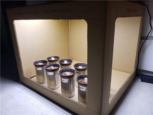

Enclosure Prototype
I found a 0.5m3 cardboard shipping box in the garage and repurposed it into my enclosure prototype. While the enclosure can certainly accommodate 32 pot systems, I chose to prototype with only 8 so I could focus on quality experimentation over quantity. More on the plant pot system in the next blog.

So are red/blue LEDs or full spectrum white LEDs a better choice? Well, considering that both yield similar growth results and that green photons in white LEDs add color to plants, white is the clear choice. I found 12V LED light strips that are 0.5m long, the perfect length for a snug fit in the enclosure, and I got a 12V power supply to accompany the LEDs. For a future iteration of this project, customizable colored LEDs with far red light would be great to implement because plants can benefit from customized light recipes. The Automation HAT could catalogue ideal light recipes per plant so that when the user tells the system what plants are in the chamber, the system would automatically activate the custom light recipe for those plants. For now, white LEDs are sufficient and within my tight budget.

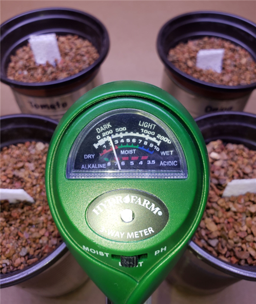

Red leaf lettuce thrives in a DLI of around 10. My LEDs produce a PPFD of a little over 200 as indicated by my light meter. Choosing a 12-hour light photoperiod yields my desired DLI. I used this PPFD to DLI calculator to quickly do the math. For the time being, I'll use an outlet timer to automate the 12-hour light photoperiod. The same calculations were used used to determine the ideal lighting conditions for tomato, onion, and cilantro.

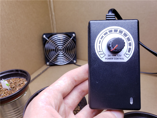

With all that time spent on lighting, it is easy to forget about other factors for plant growth. One crucial factor for plant growth that is easily overlooked is air. Natural convection currents on Earth facilitate the flow of oxygen and carbon dioxide, which we pretty much take for granted. Without natural convection currents in space, plants could suffocate in bubbles of oxygen. To ensure that carbon dioxide circulates to the leaves, I installed a small fan in the interior of the chamber.
The fan not only creates convection currents but also helps regulate temperature to a small extent. Temperature and air flow impact the rate of transpiration, the evaporation of water from plant leaves. This flow of water enables nutrients to travel from the roots up the stem and ultimately arrive at the leaves. Controlling the speed of the fan through a power supply with power control, we can regulate two key factors that impact transpiration.
