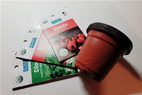

Supplies
  • Metal cans
  • Plastic pots
    • I found pots that fit perfectly into the metal cans!
  • Wicks
  • Seeds
    • Outredgeous Red Romaine Lettuce | Vegetable | deep red leaves with a nutty/sweet flavor
    • Special thanks to organic gardening consumer products startup Back to the Roots for providing me with some seeds!
      • Cherry Tomato | Fruit | bite-size tomatoes - bright red, sweet, and juicy
      • Walla Walla Onion | Bulb | large onions with mild, juicy, sweet flesh
      • Cilantro | Herb | aromatic, zesty leaves
  • Calcined clay substrate
  • Slow-release fertilizer

  1. Each pot can hold up to 300cm³ substrate and each metal can reservoir can hold up to 175mL water.
  2. Cut rectangular wicks and insert wicks through the holes in the pot. Cover up all remaining holes with tape to prevent substrate from falling out.
  3. Mix 2.25g of slow-release fertilizer with 300cm³ calcined clay substrate to achieve ratio of 7.5g fertilizer to 1000cm³ dry substrate as suggested by NASA research.
  4. Pour fertilizer-substrate combination in the pot without burying the wick and place the pot in the reservoir.
  5. Glue the seed to the wick with guar gum to ensure it maintains the desired germination depth.
  6. Initiate growth by pouring 225mL over the substrate. 50mL will be absorbed by the substrate and 175mL will trickle into the reservoir.
