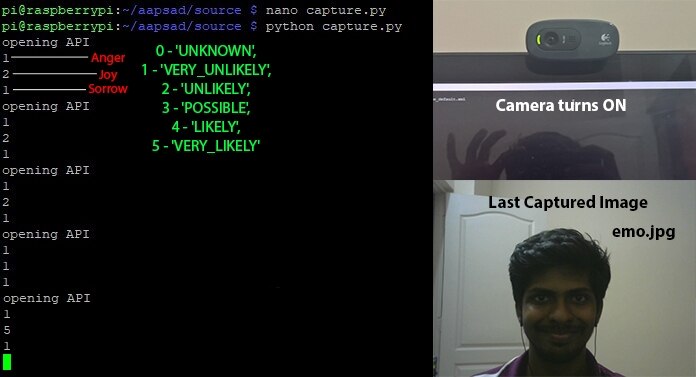

What I've done here is:
1) I've used OpenCV and a python script to capture an image and save it locally as emo.jpg, and call another python script (the Vision API).
2) This one Upload to the GCloud and returns a json response from which emotions could be fetched.

I just ran the capture.py from putty and within 2seconds this came up on the Rpi screen
Here's a short clip on the output...

    Nice update to your design challenge project. Looking at your last image and the last results, it looks like you totally nailed the 'joy' emotion, both in your ability to show joy and the programs ability…

    Just to keep a positive vibe just kept the joy, it still finds a lot, will provide a complete video over different emotion on the final blog image
