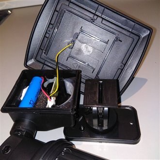

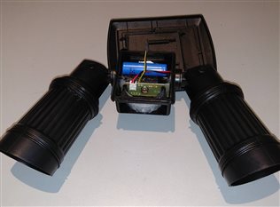

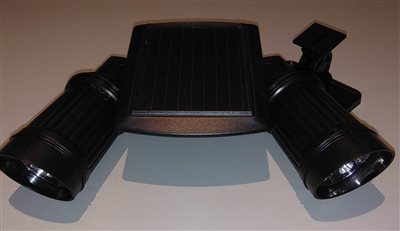

When I was visiting another retailer, I spotted these, and the importance was they used a 3.2v battery, rather than the single cell many others have.
The costs was NZ$15, and if they weren't suitable, I could still use them as they were designed.
Strangely they must be designed for another use, as the mounting bracket seems to also fit the solar panel ....

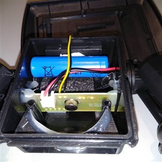

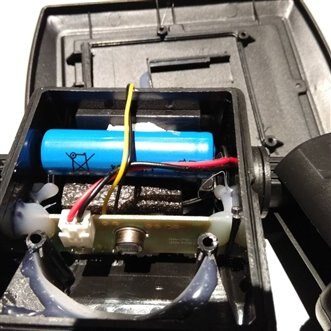

You can see there is room inside for some electronics, so it could be very useful even as a solar powered PIR detector.
As the pictures show, the construction is simple, with plenty of hot glue to hold the board and lens in place, while a bit of foam supports the 3.2v 400mAH battery.

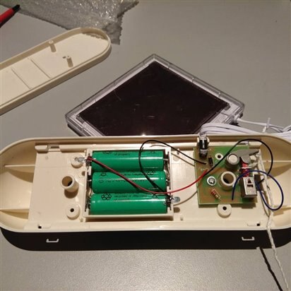

Shed Light

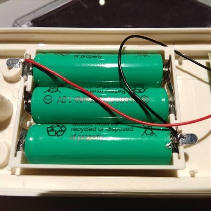

While I was picking up 2 more of the above, I looked at a Shed light.
The idea is you have a solar panel outside, and a LED light inside where it would otherwise be dark.
The LED is just a few LEDs in parallel with a small resistor, so not exactly efficient, but I wasn't after it for the Light .... just the panel.
The box suggested it used 3 rechargable cells, which by my calculation is 3.6 volts.
Once opened it reveals three standard rechargable cells 1.2v 200mAH.
So not as high as the other lights, but I'll need to do some tests to see what the panel can deliver before seeing if it is useful.
The last photo shows the build quality you can expect with these cheap devices.
The battery clip on both sides has been installed upside down, while the soldering has been while the battery is installed.
I do like the pull switch. It's a rather clever way to achieve it.
Unlike the other lights, this is definately not an outdoor unit.

    mcb1 over 8 years ago
    genebren
    My earlier post  BT_Sentry Introduction  had some info in the discussions for anyone contemplating reliable Solar.
    https://nicegear.nz/blog/what-size-solar-panel-and-battery-do-i-need/
    I believe many of the later regulation systems use a buck/boost converter to convert the incoming energy into a suitable voltage.
    Previously the method was simply to regulate it so the batteries aren't cooked.
    This means that the solar panel is effectively more efficient with the sunlight available.
    The biggest issue with using larger batteries is that at some point to need to " pay the piper " ... that is, you need to recharge the battery.
    I've suggested to my friend that he split his batteries and charge one set, while using the other, otherwise he runs the risk of damaging them with the limited solar energy he has.
    I don't have that option, so I may need to go to a bigger panel.
