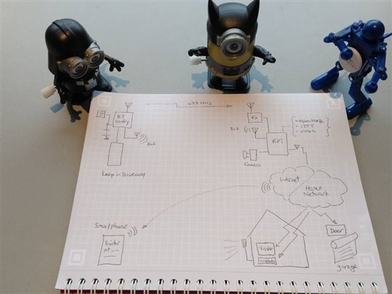

BT_SENTRY
My plan for the BlueTooth Unleashed Challenge is to use it to provide an addition to Home Automation.
Concept
The idea is to detect the bluetooth transmitted from the vehicle and signal other Home Automation functions.
If the vehicle is known then it can open the garage door, and inform the home owner that xx is home.
If the system doesn't recognise the vehicle, it can :-
  • trigger a survelliance camera to record video and take snapshots.
  • turn on the outside lights
  • inform the houseowner that they have visitors
  • Send a notification to a smartphone
This system also can record when someone visited and for how long, which may prove useful if they have been up to no good.

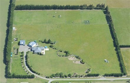

I live in the country and we have a shared driveway, and then a long (by normal standards) driveway to the house.
When we first moved in, it was open paddocks, and you could see anyone coming into the properties. Now that the trees and shrubs have grown, there is no visibility of incoming vehicles.
Being forewarned about who is coming up the driveway, gives you a few minutes to get sorted before they knock on the door.
Because we aren't always at home, having a method to capture pictures of incoming vehicles at least allows you to know what and when someone may have visited.
There are legitimate visitors during the day, but there also some others that could be opportunistic with less than desirable reasons for visiting the property.

Hardware
The detection point needs to be at the start of the driveway, and because there is no power source, this will need to be low power with solar charging.
The PSOC range seems a very good fit, but because of the timeline and my need to upskill, the inital design will be Arduino based and some form of RF transmitter/transceiver.
Adding a vehicle detection loop or beam is necessary to ensure those vehicles without bluetooth will also trigger the system.
The camera is intended to be a RaspberryPi which will be performing the receiving signal, along with storing the database of known vehicles, and the appropriate response (ie lights, gargage door, announcement)
Depending on the field tests the RPi could also be doing the Bluetooth detection as well (I prefer to avoid picking up the neighbours movements)
This will be housed in an outdoor light fitting, so as to appear normal.
Consideration for the antenna needs to be made as most of these fittings are metal.

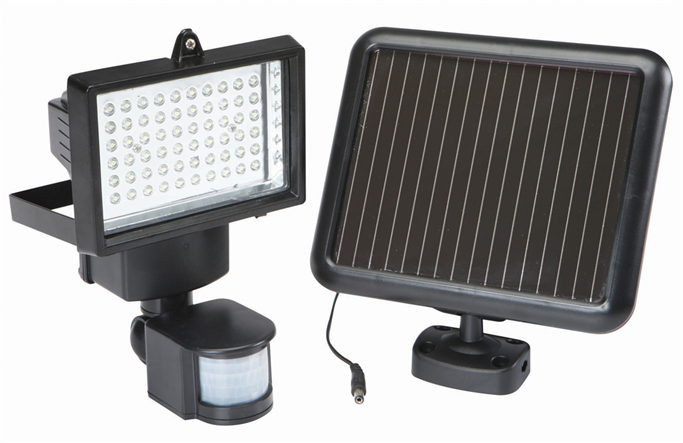

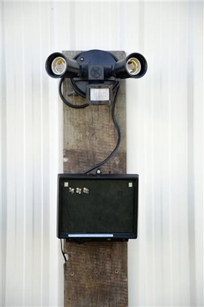

This was another done in an earlier challenge, and gives the idea, however I plan to use a version with lots of LEDs (similar to the one below) and swap out some LED's for IR and remove others to allow the camera to be mounted.

I've been twarted on my electronic picture of tying it all together, but the pen still works, and the 'Whitelines" paper https://www.whitelinespaper.com/   seemed a really good way to convey it.

    mcb1 over 8 years ago in reply to jkutzsch
    not all of our vehicles have bluetooth but everyone who drives here has a phone with bluetooth.
    Our everyday cars don't have bluetooth (well my GPS does, but it doesn't work properly so it's turned off), and I was thinking about adding a bluetooth device to the car.
    The range would certainly be varied in a vehicle depending on the phone orientation, handbag, other radiation devices, etc.
    My intention is to grab it as it goes past the entry point so the distance is 2-3m.
    Now that you've pointed it out, an elevated position might also mean I'm not trying to go through the door.
    Since BT is 2.4GHz, you should be able to apply any of the cheap WiFi tricks to extend the range.
    I saw quite a few units with external antenna, and one document I saw suggested using an external antenna
    https://duo.com/decipher/bluetooth-hacking-tools-comparison
    I've seen another that talked about a log distance, and I can't find it again...image
