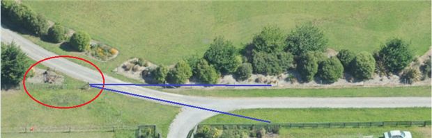

Placement
I have checked the options for placement and decided on the most suitable.
I originally said "I prefer to avoid picking up the neighbours movements"  however the need to conserve energy, now means I'll need to point the microwave detector down the shared driveway.
There are trees along the fenceline (which have grown even more since this picture was taken) and they could cause issues.
The detector operates at 3GHz and works by detecting the reflected signal.
Normally trees would not be a problem as the leaves and branches tend to absorb the signal, but if they are wet and the wind is moving them, then false triggers are possible.
At this point I haven't had a chance to experiment with modifying the microwave beam width, but the basic unit is a dipole.
The pattern is more forward/rearward than circular but this is a function of the design, and for it's intended purpose is suitable.

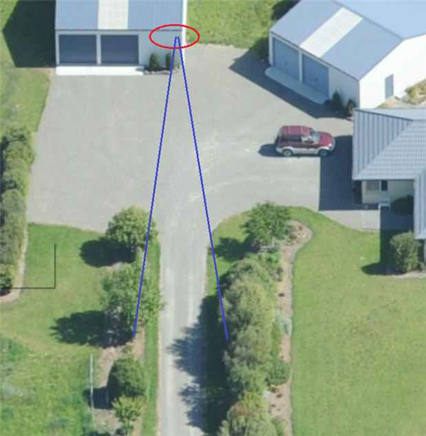

False Triggers
To help with false triggers, I intend to add a second detector on the camera location which will be facing my driveway and well inside the property.
The idea is that it would require both detectors to have been set off, to trigger an event, and therefore by elimination my neighbours will be excluded.
I'm in two minds about how narrow this detector should be.
For incoming vehicles, capturing just the driveway is perfect, and it reduces false 'events'.
BUT it's important to know when the visitor leaves, as the image leaving could help in identification of the vehicle should the need arise.
They may have been there legitimately, but they could also be knocking on the door to see if anyone is home.
As I've said in IoT posts elsewhere, you don't need to know what the data is, just that someone is home or not to improve your odds.
The visitor may have arrived and knocked on the door, and then carry on with their illegal activity, and the detector should assist in capturing that event.
I have no power issues at the camera location, so I can run the camera and BT snooping here as well, and it's sheltered enough to not have waterproofing issues like the gateway monitor.
This means that other detection methods could be employed if required.
