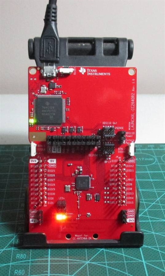

CC2640R2 Launchpad
Category:         Wireless MCUimage
Protocol:          BLE 5
Processors:      Main - ARM Cortex M3 [48 MHz, 61 uA per MHz]
                         RF - ARM Cortex M0
                         Sensor - unknown [ low power - a few uA], operates autonomously while the system is in sleep mode
RF:                    Bluetooth Low Energy 4.2 and 5 specifications
OTA:                  Supports over the air firmware update [using app]
The Launchpad consists of XDS1110 debugger, which can be separated by removing jumpers.
It has builtin PCB antenna, however there is a tiny connector for external antenna.
There are two LEDs on board. RED and GREEN at DI06 and DI07.
However, the 10pin XDS programmer connector has a component reference of "CC2650 in"!!!

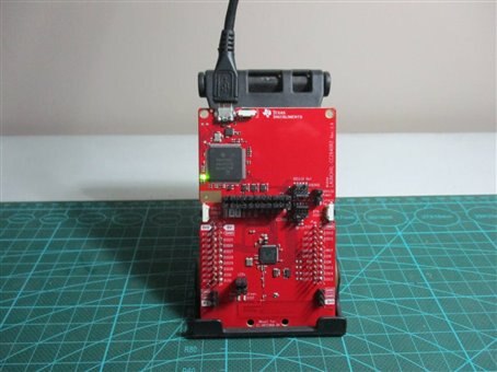

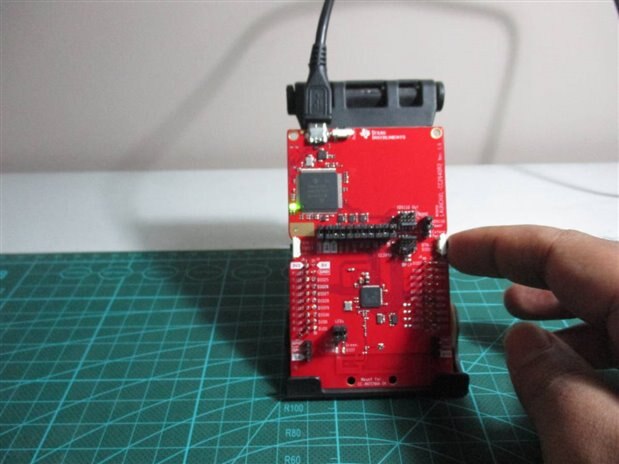

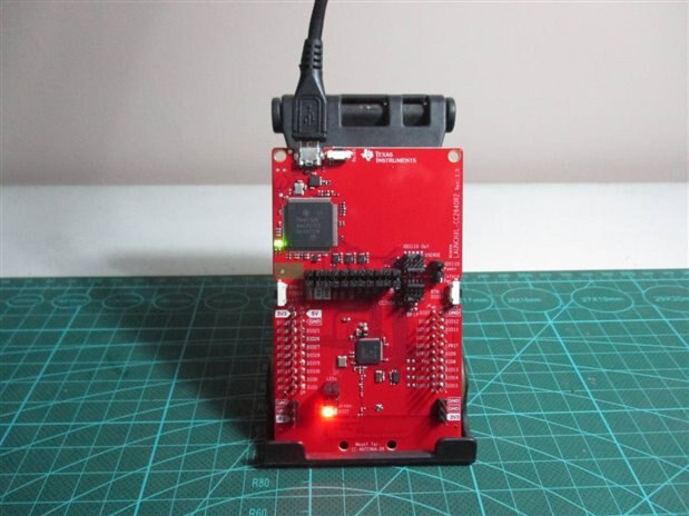

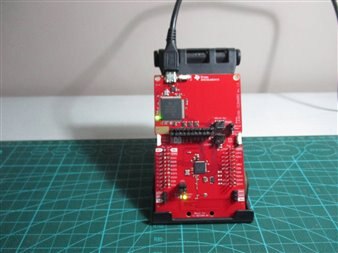

Out of the Box Demo
When I powered the board up, I found that the Green LED was flashing. Which indicated that the board was already pre-programmed with a sample code.
There was a Out of the Box demo where the flashing LED indicated that the CC2640R2 was already active and started advertising.
However, I found that the compiled build file is readily available at TI Resource Explorer ,  to flash the launchpad directly online. But there is no source code available.
At power-up, I saw the green LED flashed several times rapidly indicating a power-on-self-test to check the 'serial flash'.
At successful power-up, LED continued to blink periodically indicating active advertising.
It was a demo code for 'peripheral' function.

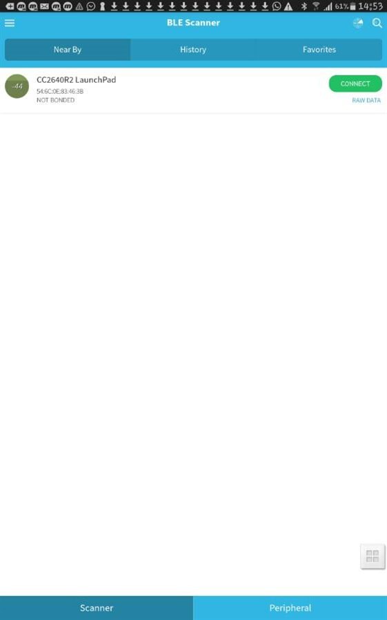

Unfortunately, I don't have iphone, so I had to look for android app and I went for "BLE Scanner" from Bluepixel Technologies LLP.
Services:
The BLE Scanner found the device with the name of "CC2640R2 LaunchPad". After connecting, there were five custom services.
{gallery} Device Scanning and Services

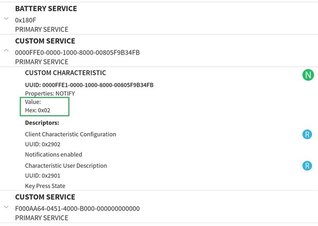

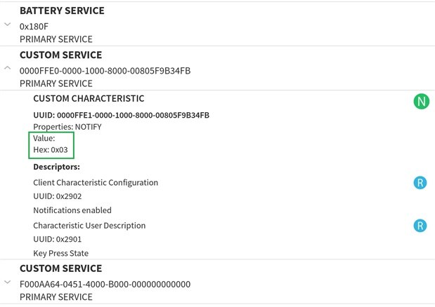

S1 Button press: Sends notification and updates the value of custom characteristics
S1 Button pressed: Notification received with a value of 0x01
S2 Button press: Sends notification and updates the value of custom characteristics
S2 Button pressed: Notification received with a value of 0x02
S1 and S2 Button pressed: Notification received with a value of 0x03

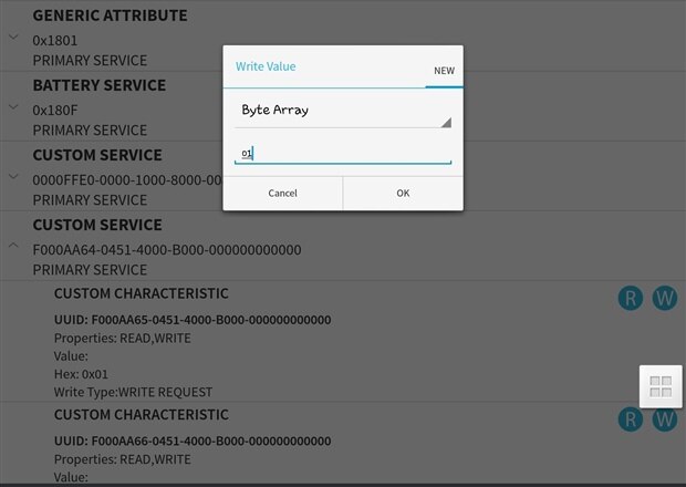

Red LED on: writing 0x01 to characteristics [UUID: F000AA65-xxxxx....] value
Red LED on: DI06 red LED turned on
Green LED on: writing 0x02 to characteristics [UUID: F000AA65-xxxxx....] value
Green LED on: DI07 green LED turned on
LED off: writing 0x00 to characteristics [UUID: F000AA66-xxxxx....] value

Custom Service - 0000FFE0-xxxxx......
It takes notification [if enabled] from the BLE device when any of the S1 and S2 button is pressed.

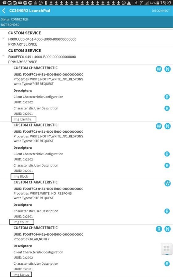

Custom Service - F000AA64-xxxxx......
It controls the on board LEDs. Value can be read to get the status of the LED whether it is at on or off state.
Writing value 0x01 [to F0000AA65-xxxx...] turns the RED LED on
Writing value 0x02 [to F0000AA65-xxxx...] turns the GREEN LED on
However, despite of the LED status, they will turn on only if the F0000AA66-xxxx..... has a value of 0x01. by writing 0x00 LEDs can be turned off.
The other three custom services could not be demonstrated by BLE Scanner. However, from the image of the official app, it seemed to be Display service to view some sort of image may be.

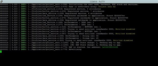

Startup:
I faced no difficulty on downloading the program into the launchpad [good for me!!]. it starts advertising immediately and sends the parameters to the serial terminal.
It also sends the address of the peer to the serial terminal after a successful connection.

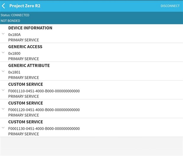

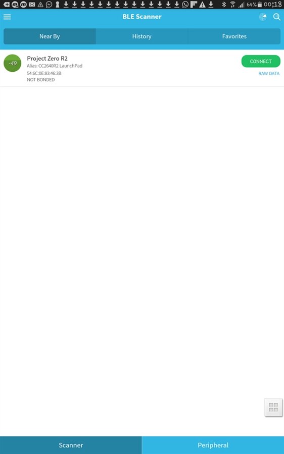

{gallery} Project0 startup
Device Scanning: Project Zero R2 found
Serial Terminal: Shows the parameters and starts advertising
Device Connected: Shows three custom services
Serial Terminal: connection status and peer address
Custom Services:
UUID - F000XXXX-0451-4000-B000-000000000000
128 bit namespace for demo applications.

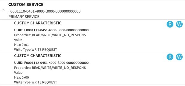

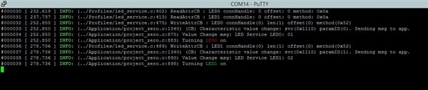

LED Control:
Unlike the 'out of the box' demo which had one characteristics to control LED, 'project zero' has two.
F0001110-0451-xxxx... has two different custom characteristics -
  • F0001111-xxxx..... controls LED0 - on board RED LED
  • F0001112-xxxx..... controls LED1 - on board GREEN LED
Values can be read from the board to get the current status. Or write values to control LEDs
0x00 represents off condition
0x01 represents on condition.
The serial terminal displays the status and activity.
{gallery} LED control
LED state: F0001111.... for RED LED, F0001112... for GREEN LED
Both LED on: writing 0x01 to both the characteristics turns on both the RED and GREEN LED
Serial Terminal: Displays the LED status and log the activity

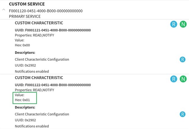

Button Press Notification:
F0001120-0451-xxxx... has two different custom characteristics -
  • F0001121-xxxx..... Button0 - on board button S1
  • F0001122-xxxx..... Button1 - on board button S2
Values can be read from the board to get the button state. Or subscribe to get notified when button is pressed.
0x00 represents open condition
0x01 represents short/button pressed condition.

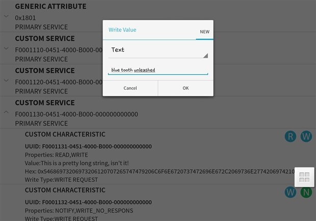

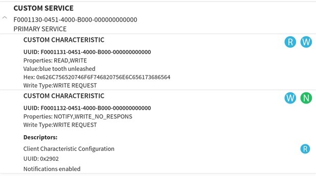

Data Service:
F0001130-0451-xxxx... has two different custom characteristics -
  • F0001131-xxxx..... String Char - Receive/Transmit a String Message
  • F0001132-xxxx..... Stream Char - Receive/Transmit a String Message without response feedback or notification

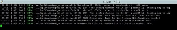

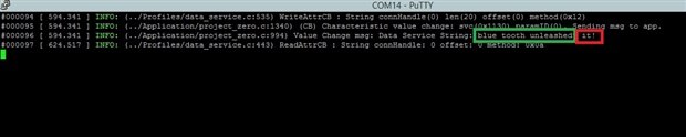

By reading the value of "String Char - F0001131-xxxx...." I got a message : "This is a pretty long string, isn't it!"
The string can be changed by writing a new message. I changed it to "bluetooth unleashed" and received it back to check.
The serial terminal logs the activity and also displays the changed string. However, I observed that when it shows the changed string, last part of the previous string comes along with the new one.
old string: This is a pretty long string, isn't it!
changed string: bluetooth unleashed
string from serial terminal : bluetooth unleashedt it!
{gallery} project 0 - data service
Data Service: Reading String char
Serial Terminal: logs activity
Data Service: Writing string char - bluetooth unleashed
Data Service: Reading it back - bluetooth unleashed
Serial Terminal: Displays activity and the changed string... but there is "t it!" at the end of "bluetooth unleashed" - comes from previous string
