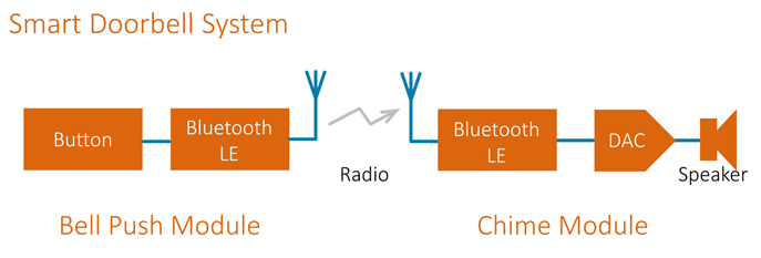

The Smart Doorbell System is an idea for a wireless and portable bell-push/chime system with hopefully better range and features than expected from existing systems! It was a project developed in ten week(ends) and evenings.

Bell Push Module and Chime Module
The source code is attached to this blog post in a file called cc2640r2-project-source.zip. To use it with TI Code Composer Studio, the BLE 5.0 stack version 1_50_00_71 needs to be installed (otherwise the code may need modification). The bell push module project is in the simple_central folder, and the chime module project is in the simple_peripheral folder. The code is very proof-of-concept, be prepared to modify it as needed. It is just a snapshot of code, and it will continue to be enhanced (it will probably be re-written).
Raspberry Pi Central and Peripheral Mode
The Pi can connect to the Bell Push and Chime Modules, in order to either tunnel events over the Internet, or to add new features like taking a photo from a Pi Camera whenever someone presses the Bell Push module, and so on. The source code for connecting to both modules is here: Smart Doorbell System - Part 9 - Working with BLE - What it is, and How to Use It!  . In that blog post, scroll to the section Creating a BLE Peripheral Device with a Raspberry Pi for the code that will receive Bell Push Module events. The section Creating a BLE Central Device with a Raspberry Pi contains the code that can connect to the Chime Module.
