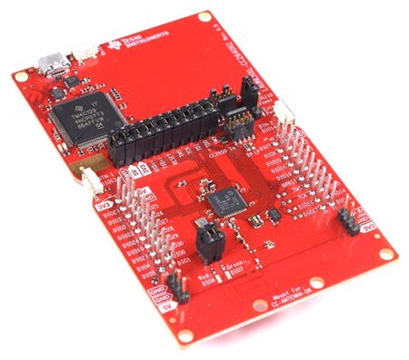

Since this design challenge is a complete project, the steps to get there will require involve producing a design from the requirements, and implementing it in software and hardware. There will be software development and debugging to do, and schematic entry, PCB layout and CAD design. The first part Smart Doorbell System - Part 1 - Getting to know the CC2640R2  examined the development board from TI, called the CC2640R2 LaunchPad (most of TI's microcontroller development boards are called LaunchPads - they all have a similar layout with dual 20-way headers for attaching daughter boards called BoosterPacks).
The LaunchPad contains the CC2640R2F integrated circuit (in a 40-pin VQFN package) along with a programmer/debugger that connects to the PC using USB. It was also explored how Autodesk Fusion could be used to directly create an enclosure based on the PCB information.

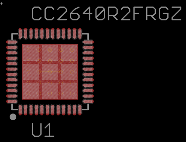

I’m using a slightly older version of Autodesk EAGLEAutodesk EAGLE, so the procedure may have changed in recent times. Rachael’s ( rachaelp ) excellent EAGLE tutorial can be used as a guide. I used the CC2640R2F datasheet to obtain all the measurements.
The final part is shown here:
Shaped pads are needed, so they were created by setting the Roundness attribute to 100% on each rectangular pad. I didn’t want solder to travel up the entire pad much beyond the outline of the component, so shapes were drawn on the tStop layer to define the area where the green stuff would be absent on the PCB, and for each pad the automated Stop creation attribute was disabled.
The patchwork of squares in the center pad area in the screenshot above are for the stencil creation, to prevent too much solder paste being applied. For radio chips the vias are mandatory for the ground plane. I will need to consider how to prevent solder wicking into the holes too much. Low-cost PCBs do not have filled via holes. I have a few ideas, but experimentation is needed.

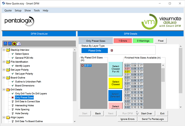

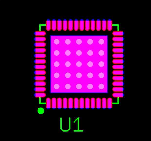

After the part was created, it was verified with a third party viewer, PentaLogix Viewmate. It works really well with EAGLE - just point it at the folder where the Gerber files (generated using EAGLE's computer aided machining [CAM] processor) are stored, and it does its magic.
The software can automatically run Design for Manufacture (DFM) rules and inform of errors and warnings that could prevent a successful PCB being manufactured. For instance in my case, it warned that the holes were of a non-standard drill size, which I can easily correct.

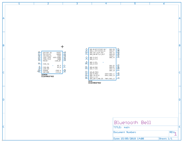

Component Schematic Entry
As part of the part creation process in EAGLE, the schematic symbol was created too. I used the TI schematic symbol as used in the LaunchPad, as a reference, but with some small adjustments to suit this project.
Since there are many pins (48 plus the center pad), the schematic symbol is split up into two parts; one for input/output connections, and the other for all the remainder connections (such as power, crystal and debugger).

    shabaz over 8 years ago in reply to genebren +3
    Hi Gene and jw0752 Thanks! I'm not so good at it, since it needs a lot of practice. The few times I've had to use QFN I've not needed vias in the pad, so this will be interesting. I did have vias in a…
    Hi Gene and jw0752
    The few times I've had to use QFN I've not needed vias in the pad, so this will be interesting. I did have vias in a heat-sink area once, and the solder dripped out when reflowing. So this time I will try to plug them up, possibly with high-temperature solder first. If that fails I'll leave micropore Kapton tape on the underside to prevent it from going further than the hole depth. But maybe it isn't needed, these holes will be smaller. Anyway, it's all an experiment.. Also, last time I used an oven, but this time I will likely use a hot air tool (and preheat the board).
    genebren over 8 years ago
    Shabaz,
    Great update on your project.  Keep up the good work!
    I look forward to seeing how your PCB work goes as I still struggle with making libraries with exposed pads and vias.
    Gene
