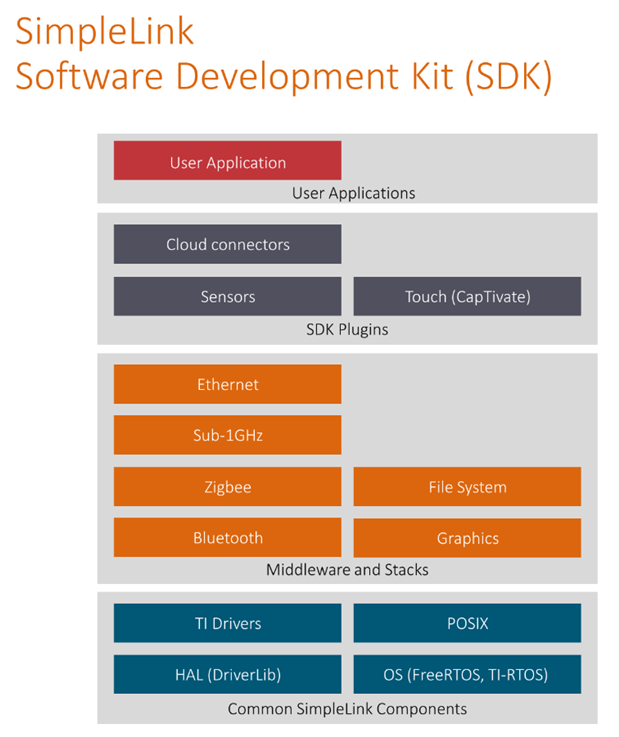

Another important consideration is the supplied library code (and example code) and the application programming interface or API. One reason why Arduino is so popular is because for the most part the API is extremely simple and is consistent across different Arduino’s. If you’ve learnt to use the Arduino Uno, then you can use the Arduino Mega and so on.
In the software engineering world another popular API is called the Portable Operating System Interface or POSIX. It is defined by a standards body (the Institute for Electrical and Electronic Engineers or IEEE). POSIX is generally adhered to for large operating systems (OS) such as Linux. Linux cannot generally run on small microcontrollers (there are exceptions but they have significant limitations), and so POSIX has in the past been less important for microcontrollers. There were other standards more suited for microcontrollers. These standards defined how tasks or processes could be started up on a microcontroller, how interaction could occur, and how typical resources such as timers and communication could be used. One example would be uITRON which was popular in Japan.
Texas Instruments has taken great care to produce a set of APIs that closely mirror those available with Linux; they are very POSIX-like, so that there is familiarity, but also lean enough to meet real-time performance needs that microcontroller use-cases may demand.
For anyone coming from a classical software engineering background, it would be a delight to use.
The APIs are separated into areas of functionality such as task/process related (very similar to the pthread API on Linux!) and network communication related (very similar to the socket API as devised by the famous W. Richard Stevens and also used in Linux today). If you like standards and you like Linux, then you’ll really like the TI APIs.

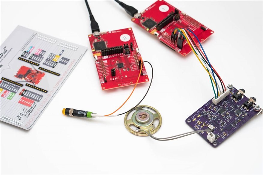

Building a Hardware Test Bed
For the Smart Doorbell System, the initial test bed was straightforward. The CC2640R2F chip is available on development boards called CC2640R2 LaunchPad (the red boards in the photo). I used one board to simulate the bell push module, and the other board to act as the chime module.
For the chime module, some audio capability is required. I wish to use digital audio since high quality sounds and flexibility is needed. A standard digital audio interface, I2S, is supported by the CC2640R2F chip, so I decided to use that. To convert to analog audio, a digital to analog converter (DAC) board is used. For now it is a board (purple board in the photo below) I created in an earlier audio project, actually intended for a BeagleBone Black, but since I2S is a standard, it will work with the CC2640R2F too. For the final design there will be a smaller and more cost-effective implementation.
The Texas Instruments LaunchPad boards come with a handy pinout diagram (shown on the left side of the photo). I wrote on it what pins I'm using, and it will become part of the final documentation.

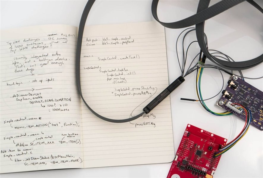

7. Take notes
There are various ways to document code yourself, I take the easy route and just scribble file names, function names and any important things I need to remember as I go. These are just mental aids to help when it comes to start modifying code.
Using a combination of the techniques listed above, the supplied example code for the CC2640R2 was modified. The example code has a menu system that allows for controlling the board from a USB UART connection. I added to the menu, so that I could simulate a button push directly from there, rather than having to push a real button. This isn’t for laziness; it allows me to develop and test code even if I do not have the hardware wired up to the board. I partially wrote this report while traveling (Milan), and some other parts of the design challenge will be written during some further travels soon. If it is not possible to be able to take a lot of hardware, then it is useful to have the ability to simulate hardware actions and see responses from the USB UART menu system and later attach hardware as needed.

    looked as if someone had busted out the cone
    That was my first thought as well ...
    shabaz over 8 years ago in reply to mcb1
    LOL : )
    I thought it looked as if someone had busted out the cone, during some listening of music that maybe they disagreed with the artistic direction of : )
    It's a transparent plastic cone, just whatever speaker I could find lying around!
