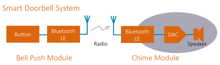

The Smart Doorbell System is an idea for a home bell-push/chime system with better range and features than expected from existing systems!
The project will use a Texas Instruments integrated circuit (IC) called the CC2640R2F which internally contains Bluetooth Low Energy (LE) functionality (this will be a wireless doorbell system!) and built-in microcontroller too.
Naturally a key part of the doorbell system is the chime or tone announcement feature! This blog post discusses the audio (chime) related functionality circled in the diagram below.

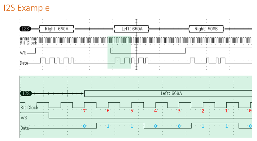

Digital Audio Interface: I2S
One standard method of transferring digital audio across a circuit board is known as I2S. It is quite flexible and allows for various sample rates and DAC resolution (bits). It is a serial interface and has three main signals; the names vary but often they are known as the bit clock, the word clock (or left/right clock or LR clock), and the data signal. For certain scenarios a high frequency signal called MCLK is also needed (especially for audiophile use-cases) but it isn’t needed for a chime. Bidirectional audio can be achieved by having a second data signal wire. For a chime, bidirectionality is not needed of course.
The diagram below shows the signals. The top half is the zoomed-out view, and the lower half in green is zoomed in to a little area. Data is clocked on the rising edges of the bit clock, and the most significant bit is transferred first. The word or LR clock has a 50% duty cycle, and left and right audio sample data is transferred alternately.
The zoomed-in area shows the byte value 0x66 (the most significant byte from the 0x669A value that is being shown in the zoomed-out view).

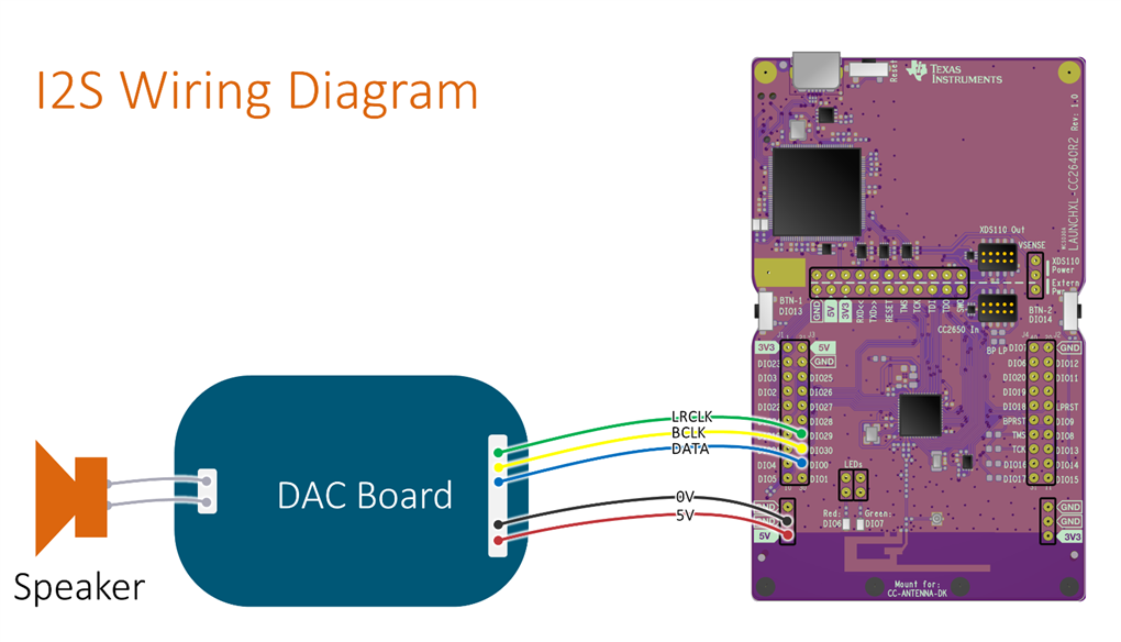

I2S Digital to Analog Converter (DAC)
To convert to analog, an external DAC is required. As mentioned in the previous blog post, I decided to test with a DAC board intended for a BeagleBone Black for now (see here: BBB - Building a DAC - part 2 ), until the circuit board is created for this project. The DAC board uses a Texas Instruments PCM5101 chip which requires very little additional circuitry, is of hi-fi quality (it is found in $300 commercial headphone DACs for PCs) and is quite low cost (around $1.20 in quantities of 1000).
The diagram here shows how to wire up the DAC board (any I2S DAC board can be used) to the CC2640R2 board, if you want to try out digital audio and coding sound effects!

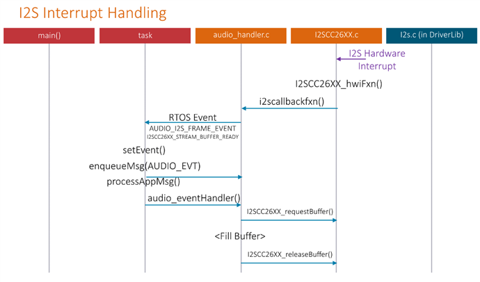

In part 3 I briefly examined the software stack and there was a diagram that showed the key components. As part of DriverLib, Texas Instruments supplies I2S code (in files i2s.c and i2s.h). There is a software stack called I2SCC26XX.c which provides a higher-level interface to audio. The key functions are I2SCC26XX_init, I2SCC26XX_open, and I2SCC26XX_startStream. I wrote a file called audio_handler.c which communicates to that higher-level audio interface.
My code registers an interrupt handler and then calls I2SCC26XX_init and I2SCC26XX_open with the desired configuration structures passed as parameters. These configuration structures define the sample rate and bits, and how frequently I want interrupts to occur. When the chime module needs to generate audio, the I2SCC26XX_startStream function is called. As soon as this function is called, the I2SCC26XX software stack will call the interrupt handler every 5 milliseconds.
It is the job of my code to use that interrupt to generate a message for the operating system (OS) that the running thread can read; it will fill a buffer every 5 milliseconds with the next chunk of audio that needs to be played. I chose a value of 5 milliseconds to reduce the amount of RAM usage; the more frequent the interrupts, the smaller the buffer needs to be. That’s it! In principle it is easy, but it did take me a few days of effort to figure it out. The development environment is great; it is easy to set up breakpoints but I reduced reliance on that, and used print statements over the serial UART console.
For now, I have hard-coded the bitstream configuration to be 16-bit digital audio at 16k samples per second. This is a fairly good capability for a chime I think; it is sufficient for up to 8kHz sounds. I have chosen a mono output (both the left and the right channels will play the same sound, I don’t need stereo. The relevant files of code are attached to this blog post for anyone who wants to experiment now, rather than waiting for the end result. When it is run on the CC2640R2 board, press the button labelled BTN2 on the board and the I2SCC26XX_startStream function will execute and the audio will be generated.

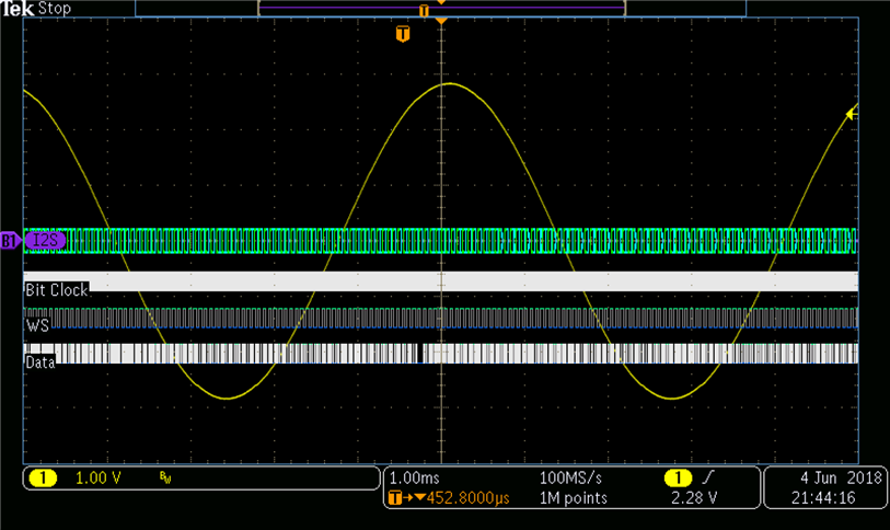

The work in this blog post was tested out, and the oscilloscope screenshot shows the result; a 200Hz good quality output.
Summary
This blog post focussed on the audio output capabilities, and successfully generated a good quality tone. The structure is in place for more advanced sounds.
