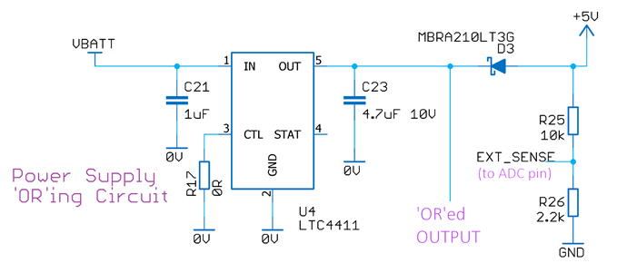

The switching between the external DC supply (from the mains) and the battery is done using diode OR’ing. For this revision 1 circuit I used an off-the-shelf ideal diode integrated circuit due to project time constraints, otherwise a discrete MOSFET circuit could be used to save costs.

Two 3.3V regulators are used to power the LaunchPad board, and the DAC. The power source for them is taken from either a +5V supply derived from the external DC power brick, or from the battery, using the OR'ing circuit. The reason to have two separate 3.3V regulators is to limit noise getting into the DAC analog circuitry, to maintain audio quality.
