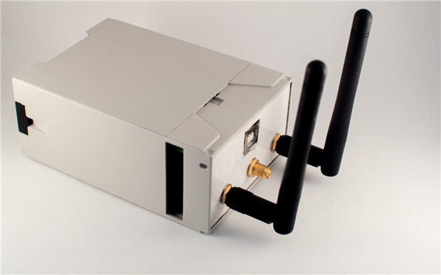

So my choice fell on option # 3. In one of the commercial projects entitled "Electromagnetic monitoring system" for a number of system units, we use Bopla industrial cases:
In the photo you can see the "Wireless communication unit" of our commercial system. This unit is placed in the [Bopla CombiNorm-Classic CN 45 AK] case. The housing has the following characteristics:
  1. Dimensions: 45x75x109.5 mm;
  2. Material: ABS plastic;
  3. Mount mechanism: DIN rail clip;
  4. Protection class: IP40.

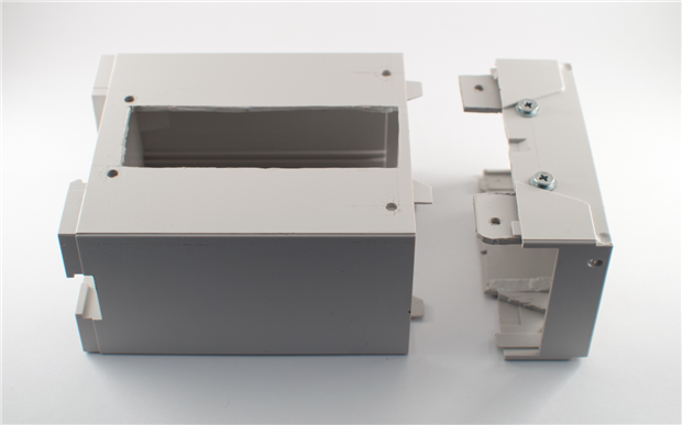

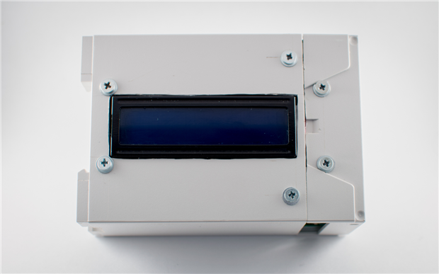

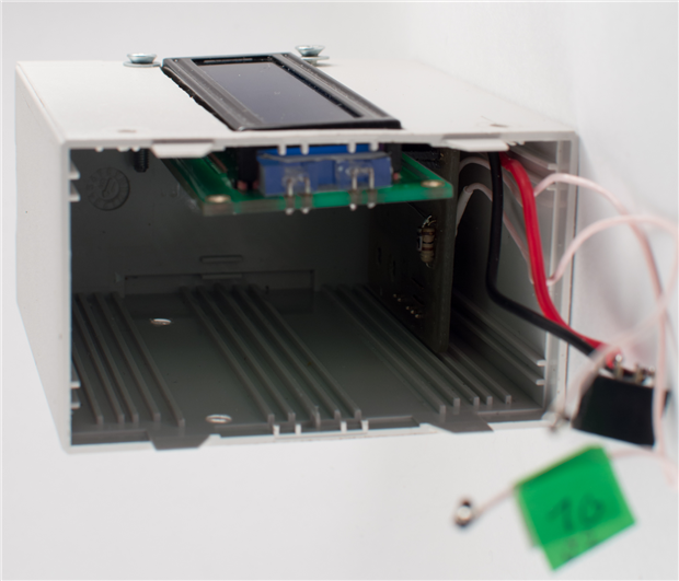

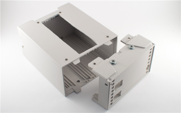

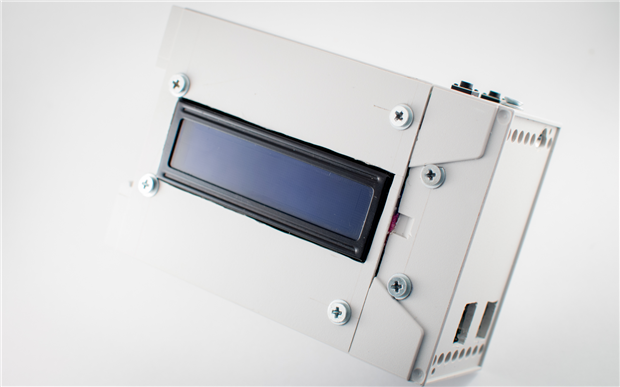

We purchased these cases in abundance and I was able to take one for my hobby project. Here’s a brief list of all the upgrades I had to do:
  1. DIN rail clip removed;
  2. a hole for the HD44780 display was cut out;
  3. one of clips fastening housing cover was cut off (it interfered with display mounting);
  4. a mounting bracket for the housing cover was made from the plate cut in step (2);
  5. stiffeners interfering with installation of boards removed from the housing cover;
  6. holes and threads for mounting the display and boards;
  7. holes for two USB ports and a mini-Jack port.
Of course, before making any changes, I carefully measured everything and made sure that the parts were really placed in my case. To perform all the above modifications of the case, I used following tools:
  1. Wireless drilling kit Makita 8391 DWPETK;
  2. Wireless Dremel 7750 + rigging Dremel 687;
  3. A set of taps and dies Zubr Expert 28129-N32;
  4. A set of files (made in USSR).
The work on the case was titanic: a high-quality thick-walled case Bopla has a large number of stiffeners, so milling holes took quite a long time. The result of my work is presented in the figure below:

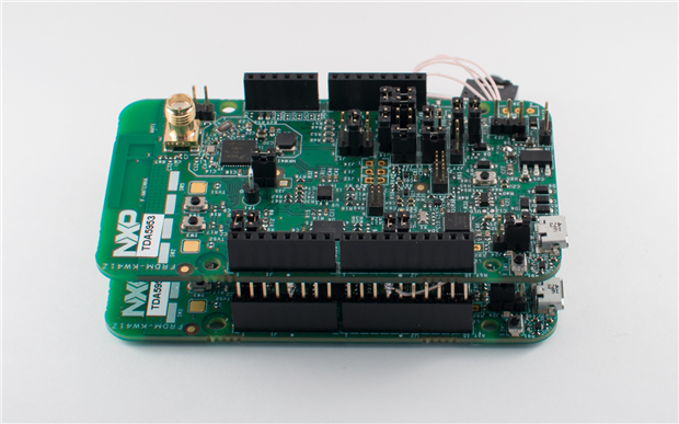

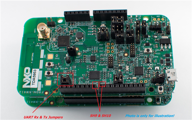

Sandwich made of boards
Having installed the LCD into the case I tried to put development boards inside it As it turned out without any modifications you can install in the case only one board either FDRM-K64F or  FRDM-KW41ZFRDM-KW41Z This situation did not suit me because I wanted to use the case for installing two boards at the same time
At that very moment, I had an idea: what if I make a sandwich of boards? The KW41Z has PB sockets on the front side and PLS pins on the back side. So I can put one board on another as a sandwich. I had two options:
  1. The top board will be KW41Z, and the bottom one K64F;
  2. The top board will be KW41Z, and at the bottom will be another KW41Z.
Option (1) was the simplest, but it turned out that such a sandwich does not fit in my case. I tried option (2) and I was disappointed again: PLS pins and battery compartment on the bottom board interfered with the installation of our "duo" in the case.
As a result, I had to go to extreme measures – to bite off all PLS pins from bottom board and also to solder off the battery compartment. As a result, the sandwich finally fit into the case! The solution seems to me to be very aesthetic:
After connecting the boards, I immediately got a problem: the boards did not only start to be powered from one source, they began to be programmed from one programmer, and simultaneously! Thus, during programming, I had to separate the sandwich.
The solution to this problem was found with a detailed research of the [circuit] of the KW41Z board. In order for the boards to be programmed separately, it was necessary to remove fuses SH9 and SH10 from one of them. I preferred to perform this procedure on the bottom board.
Another problem caused by the direct connection of the two boards was that the UART interfaces were not connected correctly:
  • Rx line of upper board was connected to Rx of bottom board;
  • Tx line of upper board was connected to the Tx of bottom board.
For normal operation of UART, as it is known, a different connection is required:
  • Rx line of top board must be connected to Tx of bottom board;
  • Tx line of top board must be connected to Rx of bottom board.
Solving this problem turned out to be amazingly simple: it was only necessary to change the location of jumpers J30 and J31.
At this work on the sandwich was completed and until now no new problems arose.

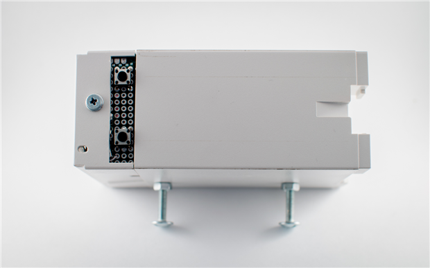

Let's start with the first question: LCD control board. As you remember, to connect the display to the microcontroller I use a [special board] with PCA9675PW chip.
The problem is that this board does not fit between the display and the sandwich of  FRDM-KW41ZFRDM-KW41Z As a result I had to turn it at an angle of 90 degrees and also replace the angle connector PLS with a more compact one and position it(the connector on the other side of the board As a result I got the following layout

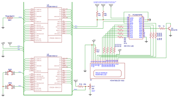

The control buttons were to be connected in parallel with SW3 and SW4 buttons of KW41Z boards. The line J1-5 corresponds to the button SW3, and the line J3-1 to the button SW4.
I placed the buttons on an additional board, on which I also placed a mini-Jack connector used to connect the sensors. Two sensors are connected to the mini-Jack: a digital reed sensor (line J2-4) and an analog potentiometer used for [tension measurements] (line J4-2).
The final scheme of the Smart exercise bike computer is as follows:

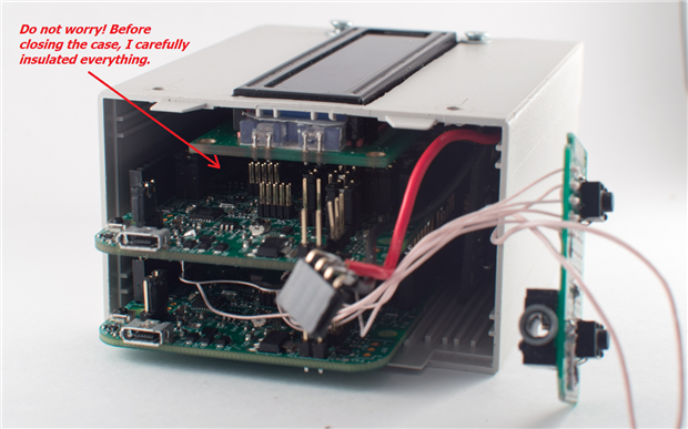

As for the issue of connecting wiring, I used a little know-how, due to which I managed to save maximum space in the case of the device!
In the finished form, the configuration of the case is as follows:
After all the boards were securely fixed, and the case was assembled, the work on the hardware part of the bike computer was completed. In its final form, Smart exercise bike computer looks like this:

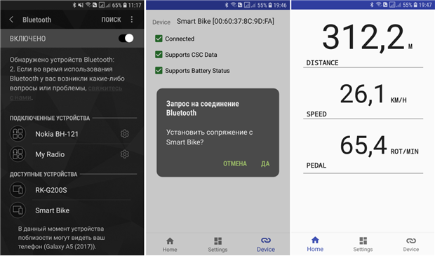

Testing of the bike computer in reality
The hardware platform of the project is developed, the writing of the firmware is completed. It remains only to experience our computer in real training!
I will give a brief list of preliminary preparations that I performed before this crucial step:
  1. Fasten the new bike computer in place of the old one;
  2. Connect sensors to the computer through mini-Jack;
  3. Connect PowerBank to the computer via USB connector.
In the beginning, I had a small problem: PowerBank periodically turned off, the fact that it is designed to charge a mobile phone and if you connect it to a low power consumption device, it simply turns off about every 60s! This problem may be fixed in various ways:
  1. Add to the bike computer an additional ballast resistor;
  2. Connect a mobile phone to the bike computer, so we can not only increase the load on PowerBank but also recharge the phone.
  3. Enable the special PowerBank mode that prohibits automatic shutdown;
I chose way (3): if I press the power button three times on my PowerBank, it switches to a special mode of operation and is no longer disconnected (this function was not documented and was detected experimentally by me).
So, instead of a thousand words I offer you a short video on which I test my creation:
In this video, I tried pairing the computer with the [NXP IoT Toolbox] application. Above, I mentioned that my computer is basically compatible with any applications that support the GATT CSC protocol. To confirm these words, I offer you screenshots of the work of my bike computer in conjunction with another application: [Cadence & Speed Computer].
