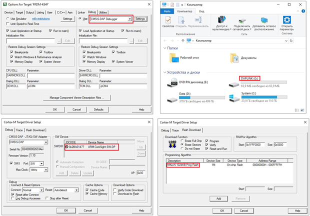

I want to remind you that I got a FRDM-K64F within the Road Test, held in 2015 year and it turned out that the work of the old revision of the board together with the modern Keil version and Windows 10 requires some cunning manipulations:
  • it turned out that the bootloader flashed in my board was not compatible with Windows 10, this problem was solved [by this article];
  • then it turned out that the restored bootloader is not compatible with Keil, and for normal operation I had to flash the board again, this time by firmware [DAPLink];
  • in conclusion, it turned out that Keil needs to manually register the Programming Algorithm and only after that I finally got it working!
At this point, I was able to flash one of the demo examples (gpio_led_output) on FRDM-K64F board. The example successfully worked and for this reason I took its structure for my further experiments.

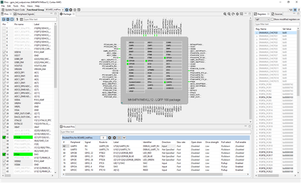

While writing the program, I faced the problem of GPIO lines initialization, it turned out that NXP has a special program with a GUI, which is specially designed for the initial configuration of all lines used in the project. This program is called MCUExpresso Config and is available via [link].
