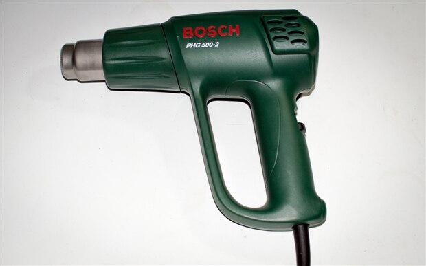

The hot air gun I ordered is necessary for me to work with plastic. When choosing I was guided by the following criteria:
  • a well-known and reliable brand (in Russia everybody knows and loves Bosch);
  • low price (this hot air gun cost less than $50);
  • relatively high power (1600 W);
  • possibility of power adjustment;
  • possibility of installing additional attachments.
I was a little surprised by the fact that one of our contest participants fvan uses exactly the same hot air gun, it turns out that the engineers ideas converge!

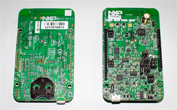

Now for the development board For me it was a surprise that  FRDM-KW41ZFRDM-KW41Z is not a development board but two development boards in one package!
In this regard I have several ways to further develop the project:
  1. Use only one KW41Z in the computer.
  2. Use one KW41Z to work with Bluetooth and another KW41Z for working with LCD and sensors.
  3. Use KW41Z to work with Bluetooth and K64F for working with LCD and sensors.

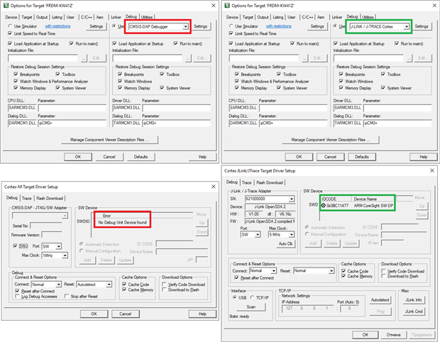

First experiment with KW41Z: Keil
To implement solutions (1) and (2), it is required to write software for KW41Z using the Keil environment. As I said Keil does not have a full SDK from NXP, for this reason I needed to integrate the SDK components manually. The most difficult aspect (as though it did not seem strange) of this task was writing the custom linker configuration file:

Another thing I had to tinker with just like in the case of [K64F] – was a problem with the DAP-Link Debugger, but today everything was much simpler: you just had to choose J-LINK instead of DAP Debugger in Keil's settings and it all worked right away!
Having coped with all the problems, I was able to write my first program for KW41Z, the main function of which is listed below, and the full listings are available in the [official repository] of the project in [KW41Z] branch.

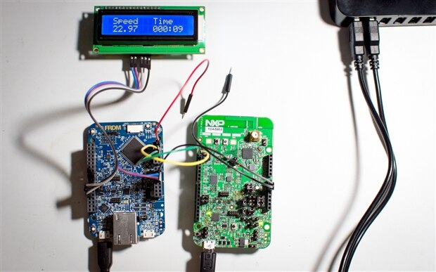

To conduct the tests, I collected all the components of the bike computer on my desk and as experience I applied to this system by simulating a reed sensors signal with a frequency of ~1 Hz:

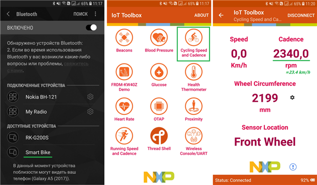

For today's experiments, I installed the NXP IoT Toolbox on my smartphone Samsung Galaxy A5. This application almost immediately started working with my bike computer, so I did not need any further work on this part:
As you can see, the discrepancy between the speed values on the bike computer screen (22.97 km/h) and the mobile application screen (23.40 km/h) is 0.43 km/h, which is below the maximum permissible error, which we mentioned above.
