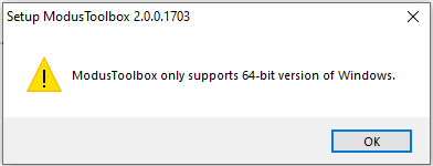

I've followed ModusToolbox Installation Guide, but I've missed an important system requirement. It doesn't support the OS I'm using - Windows 10 32-bit. So I've got the error:
I have an old box with Ubuntu 18.04. It has only 1.5GB of RAM and one CPU core. It is much smaller than recommended for ModusToolbox.But installation completed successfully. And I was able launch it.

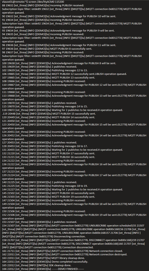

I've installed terminal emulator, so I can get output from the board:
sudo apt install screen
Than I've started the terminal emulator.
screen /dev/ttyACM0 115200
And I've started the demo program on the board:
0WLAN MAC Address : 00:9D:6B:63:76:09
WLAN Firmware    : wl0: Sep  5 2019 23:24:33 version 7.45.98.92 (r722362 CY) FWID 01-f7128517
WLAN CLM         : API: 12.2 Data: 9.10.39 Compiler: 1.29.4 ClmImport: 1.36.3 Creation: 2019-09-05 23:10:00
WHD VERSION      : v1.70.0 : v1.70.0 : GCC 7.2 : 2019-12-02 04:14:53 -0600
.1 5585 [Tmr Svc] Wi-Fi Connected to AP. Creating tasks which use network...
2 5585 [Tmr Svc] IP Address acquired 192.168.1.71
3 7301 [Tmr Svc] Write certificate...
4 7841 [iot_threa] [INFO ][DEMO][lu] ---------STARTING DEMO---------
5 7843 [iot_threa] [INFO ][INIT][lu] SDK successfully initialized.
.6 12654 [iot_threa] [INFO ][DEMO][lu] Successfully initialized the demo. Network type for the demo:7 12654 [iot_threa] [INFO ][MQTT][lu] MQTT library successfully initialized.
8 12654 [iot_threa] [INFO ][DEMO][lu] MQTT demo client identifier is bio01 (length 5).
.9 16322 [iot_threa] [INFO ][MQTT][lu] Establishing new MQTT connection.
10 16324 [iot_threa] [INFO ][MQTT][lu] Anonymous metrics (SDK language, SDK version) will be provid11 16325 [iot_threa] [INFO ][MQTT][lu] (MQTT connection 0x8012778, CONNECT operation 0x800c168) Wai.12 21325 [iot_threa] [INFO ][MQTT][lu] (MQTT connection 0x8012778, CONNECT operation 0x800c168) Wai13 21325 [iot_threa] [ERROR][MQTT][lu] Failed to establish new MQTT connection, error TIMEOUT.
14 21326 [iot_threa] [INFO ][MQTT][lu] Network connection closed on error.
15 21626 [iot_threa] [INFO ][MQTT][lu] (MQTT connection 0x8012778) Network connection destroyed.
16 21626 [iot_threa] [ERROR][DEMO][lu] MQTT CONNECT returned error TIMEOUT.
17 21626 [iot_threa] [INFO ][MQTT][lu] MQTT library cleanup done.
18 21626 [iot_threa] [ERROR][DEMO][lu] Error running demo.
19 21626 [iot_threa] [INFO ][INIT][lu] SDK cleanup done.
20 21626 [iot_threa] [INFO ][DEMO][lu] -------DEMO FINISHED-------

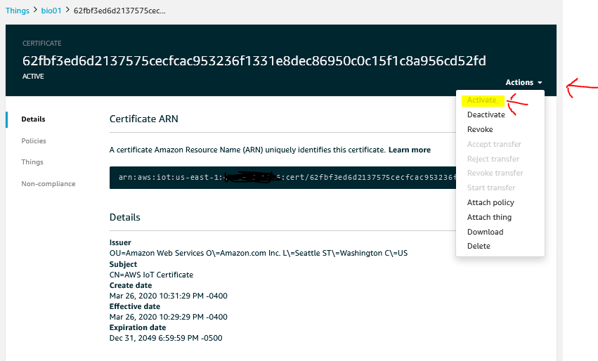

The board was able to connect to my WiFi network,but than it failed to connect with AWS IoT MQTT broker (line 14).
Unfortunately I was not able to find any debug information on the failed connection on AWS IoT Console.
I've opened support ticket at AWS IoT community forumhttps://community.cypress.com/message/229183#229183and at Cypress Community forum,
I was able to find the issue next day. It appeared that I missed one step in the on-boarding of the device and haven't activated its security certificate.
I was able activate it from the thing security page:
And than I was able to run the demo program from the board, create connection, publish and receive messages:
