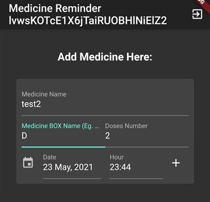

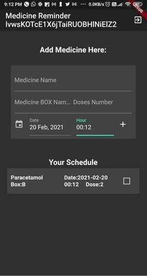

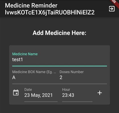

UI:
Adding Medicine UI

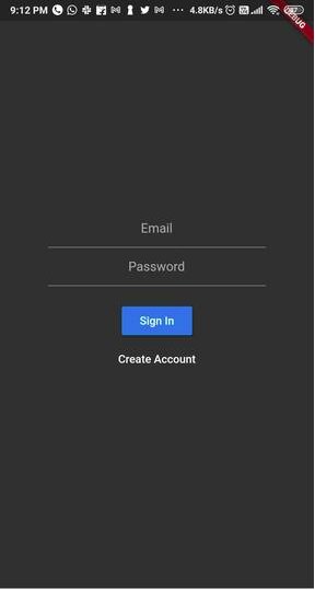

Authentication
The App is made for authenticated users, whenever he logs in he will be able to view his own medicine schedule.
The Authentication is Done using Firebase Auth ,
The user will get Login/Register Screen at start of screen. If user is logged in he will see the home page.
