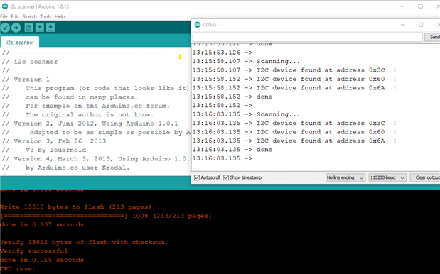

Connecting the OLED to the Nano
  • An OLED Example Project
    • II was able to connect the OLED display to my Arduino by following the following project on instructables.com/
      • how to connect and test a 0.96" i2c OLED display module to an Arduino
  • My Notes and Comments
    • The example is using a different Nano model, I was able to get it working on my Nano 33 IoT just fine
    • The example wired an external 5v supply, but I found that a connection to my Nano +3v3 pin worked fine.
    • I placed the OLED on the same breadboard as the PulseRate sensor described above .
      • The 4 pins of the OLED, are inserted to the breadboard female pins 24, 25 ,26 and 27, and jumper wires are connected to the Nano breadboard pins 8,9,2 and 14 respectively.
        • GND pin (27)  - Nano GND  (14)
        • VCC pin (26)  - Nano +3v3 pin (2)
        • SCL pin (25)  -  Nano A5 pin (9)
        • SDA pin (24) -  Nano A4 pin (8)

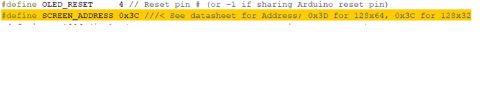

      • It was suggested to run the sketch I2C_Scanner, to find out the I2c address of the OLED board, which I did and it return 3 addresses. I assumed 2 were for the Nano 33 IoT. So I unplugged the OLED and ran the Sketch. Sure enough, by process of elimination, I was able to rule those 2 out of the possible addresses.
        • I found that the address of the OLED was the same as the one defined in the code described later in another Step.
        • I2C_Scanner run
      • Now you are instructed to Install the OLED Libraries from the IDE.
        • I found that installing them with the Arduino IDE library manager worked out great. The Example Project gives the links to the 2 GitHub repos if your interested.
        • I also found it easy to search for "Adafruit_SSD1306" and installing it while clicking on the option to include dependence's, installed the "Adafruit_GFX_Library" as well. Nice!!
      • Finally I ran the OLED test sketch described in the Example Project
        • I opened the example in
          • "Examples/AdaFruitSSD13061/ssd1306_128x64_i2c"
        • I did not have to change the I2C Address as described in the example project., because it was already set to the value of 0x3c,
