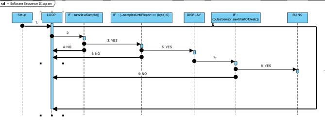

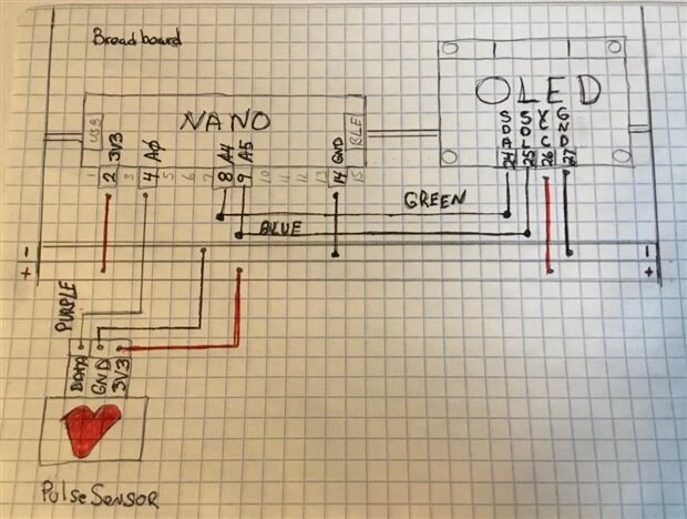

  • This blog will describe the breadboard circuit with the Arduino MCU and the OLED Display. The software will also be described in a Sequence Diagram to show the flow of the logic.

    • Breadboard Wiring
My first attempt at wiring attempt
The Wiring diagram.
My second wiring job using WayinTop jumper wires.
  • Software Design
    • Sequence Diagram
      • Here is the Sequence logic design for software.
    • image
    • Libraries
      • The libraries are the same used in Blog#2
  • Conclusion and Summary
    • This is a very short Blog, compared to Blog#2.
    • This is because I plan on using the Wiring and Code from Blog#2 to implement my idea
    • My next blog will describe the Implementation of my design.
