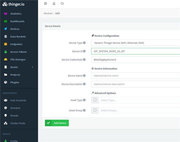

We open the main console and in the Devices section we click on the Add Device button.
As in the case of our post 11, we fill out our form as shown below:
We use the same data in our source code that we will upload to our Arduino NANO 33 IoT board: iot_system.ino

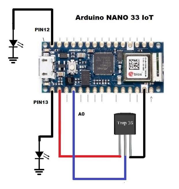

The electrical diagram is shown below.
HOW DOES IT WORKS?
  • The LED diode connected to pin 13 is controlled remotely by means of a switch and using the Thinger.io platform.
  • The LED diode connected to PIN 12 is controlled remotely by means of a slider and using the Thinger.io platform.
  • The TMP36 temperature sensor is sampled and its readings are sent every 5 seconds to the remote iot Thinger.io server.

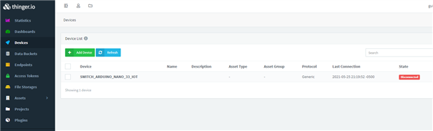

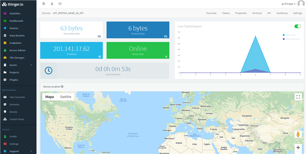

In the image below we believe that our system is working very well.

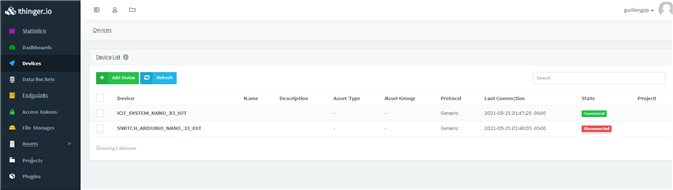

In the main menu, we also verify in the Devices section that our device "IOT_SYSTEM_NANO_33_IOT" is connected.

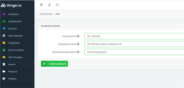

Now we go to the Dashboards section and click on the Add Dashboard button and fill in the form as shown below.

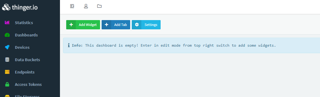

We click on the Add Dashboard button and the image below is shown to us with a warning that we go into edit mode to add widgets.
The next step is to create three widgets: a switch for the first LED, a slide bar for the second LED, and a gauge for monitoring the TMP36 temperature sensor. In order to make this project more didactic, I will describe this topic in the next post since several points have to be clarified: Blog #13
