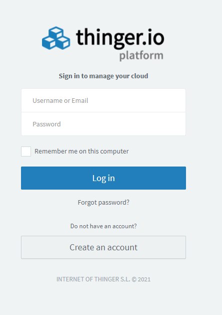

Thinger.io is an open source iot platform, here we will find many free resources as we will see below. The first step will be to open a free account on thinger.io

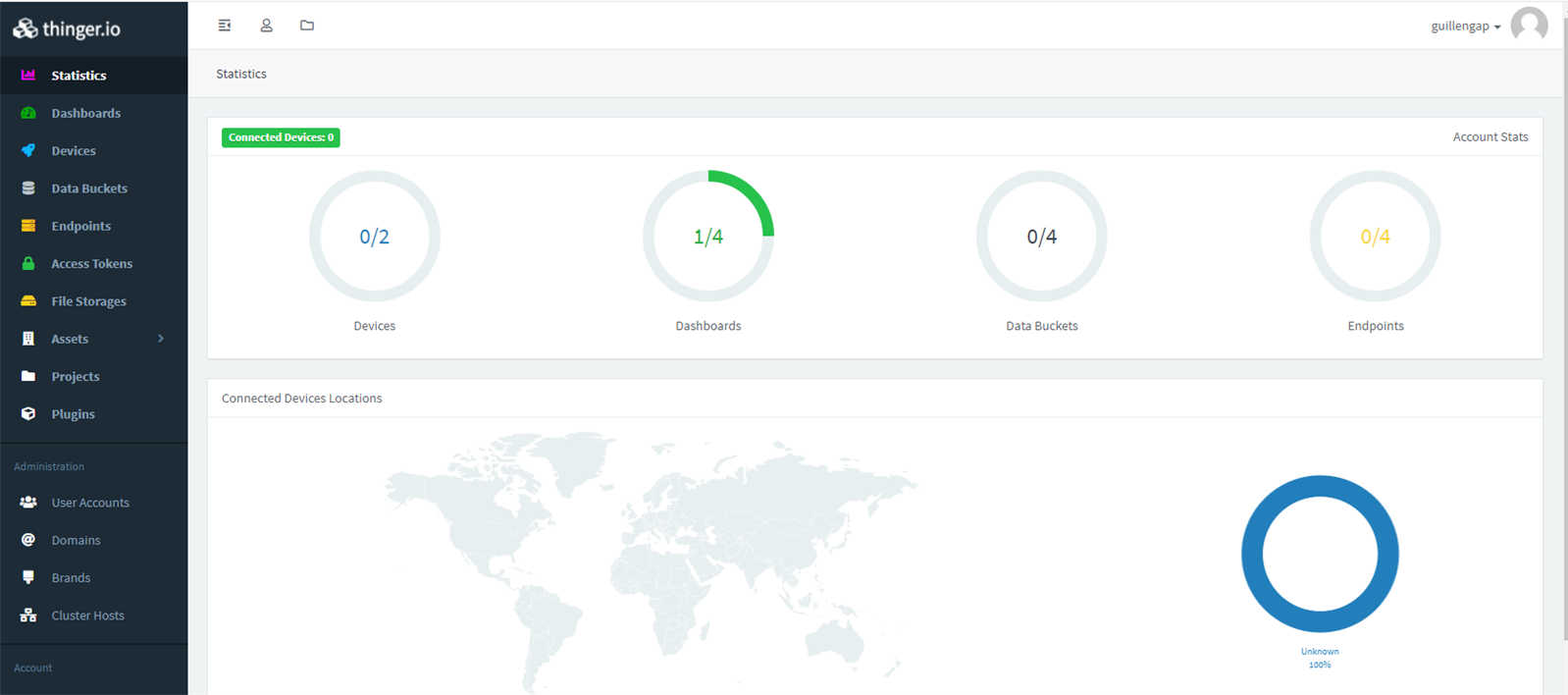

The console dashboard is shown below.

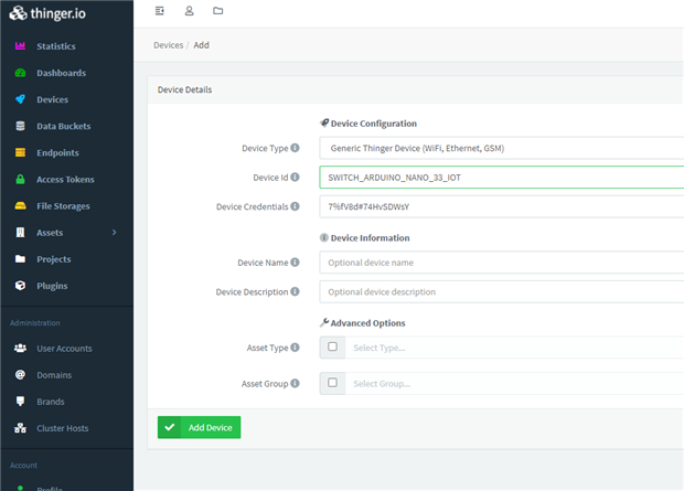

ADDING DEVICES
We go to the Devices section and click on Add Devices.
We click on the Add Devices button after filling in the "Device Id" and "Device Credentials" fields.
We type this data in our Arduino NANO 33 IoT board code as shown below: switch.ino

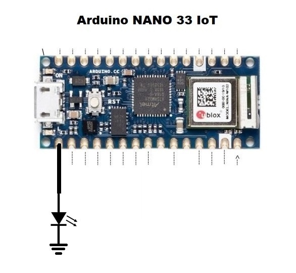

The electrical diagram is shown below.

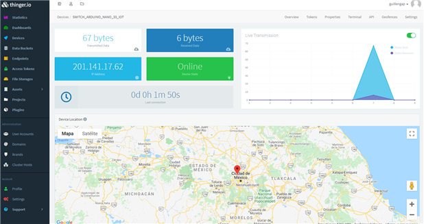

The image below is shown to us after uploading the code on our Arduino NANO 33 IoT board:

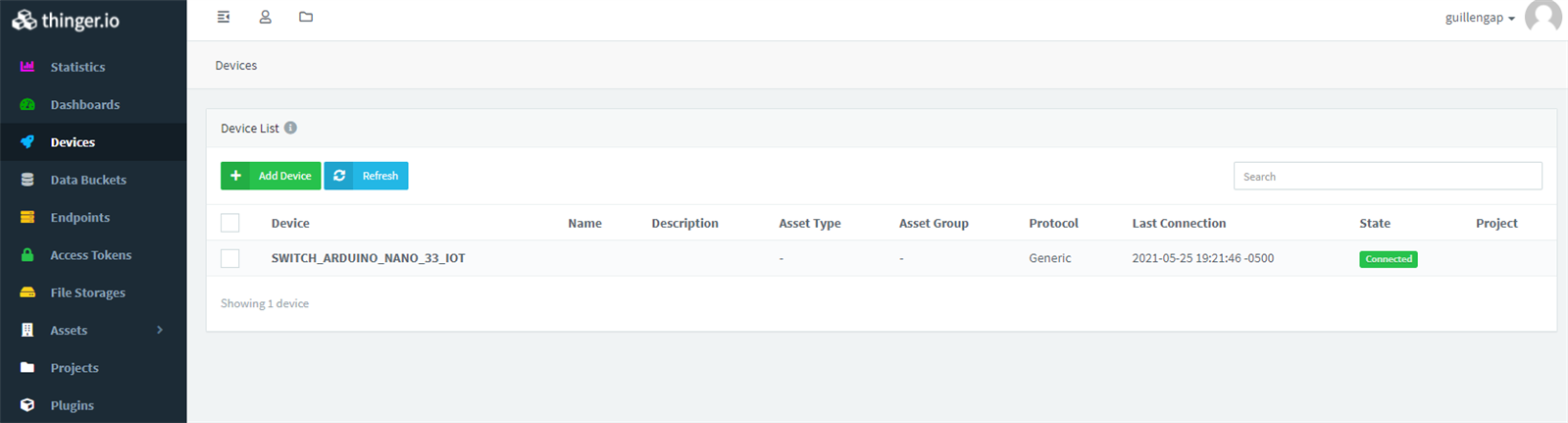

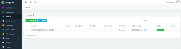

In our Devices section, we also see the connection established with our board.

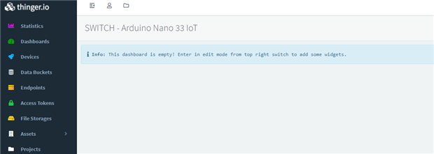

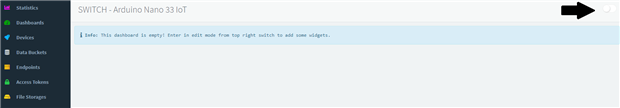

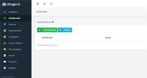

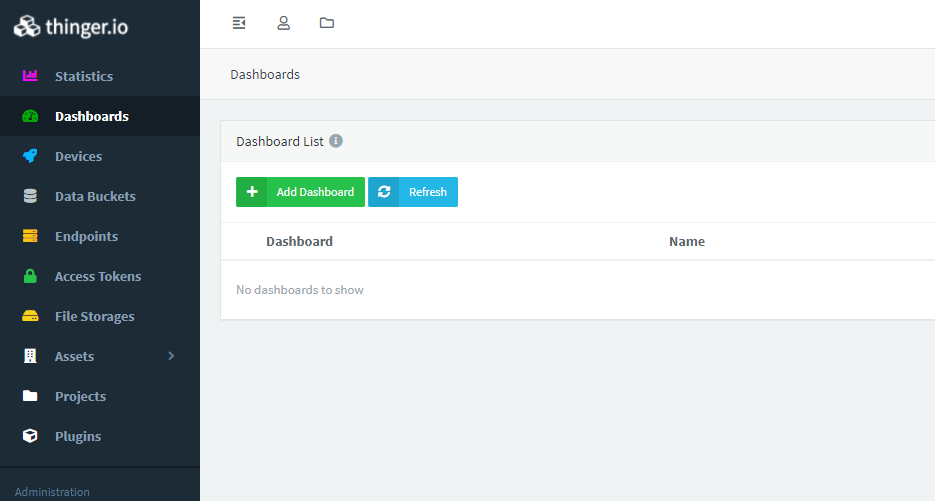

ADDING DASHBOARDS

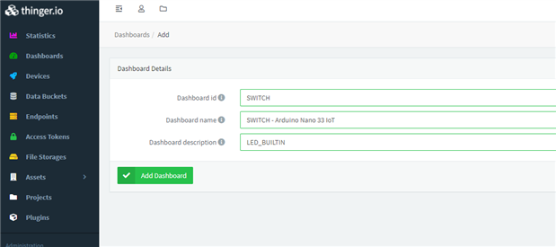

Now we go to the Dashboards section, it is empty as we see below. Click Add Dashboard
As shown below, we fill in the following fields: Dashboard Id, Dashboard name, and Dashboard description.
Click on the Add Dashboard button and the message below appears:
Info: This dashboard is empty! Enter in edit mode from top right switch to add some widgets.

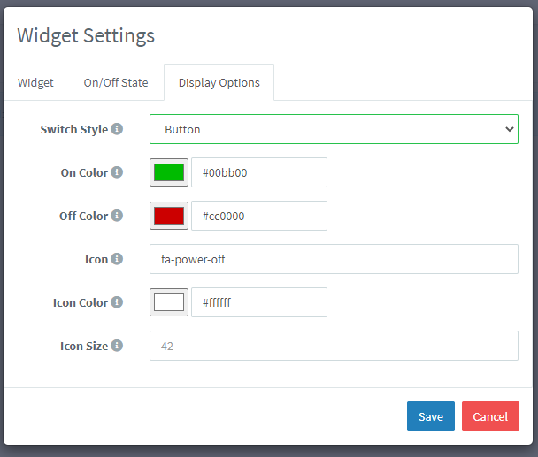

ADDING WIDGETS
To enter the widget editing mode, we click the right button on our screen as shown below:

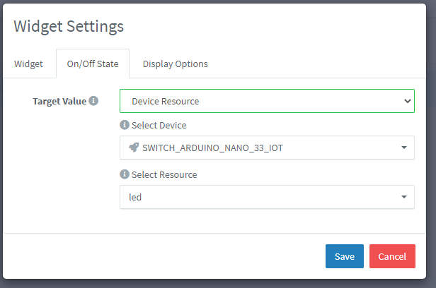

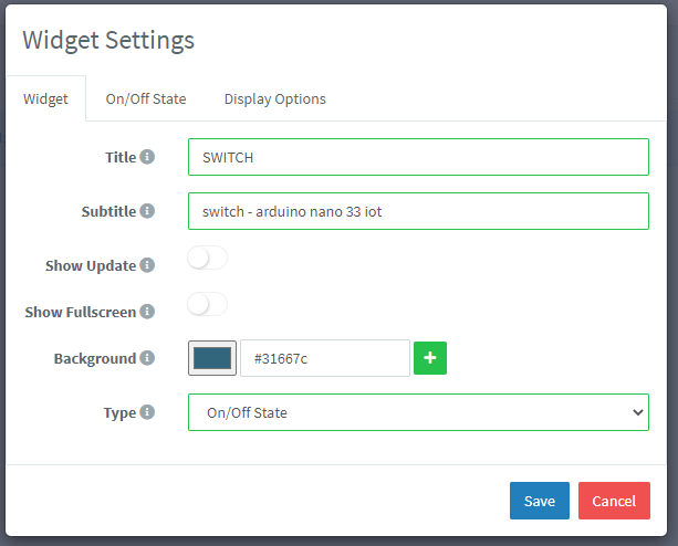

We fill in the next information in the "Widget" tab
We fill in the next information in the "On/Off State" tab
We fill in the next information in the "Display Optins" tab

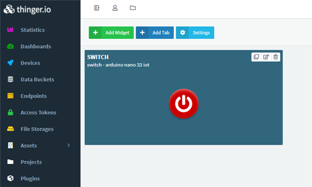

When we click on the Save button, we are shown the following image below with our button edited.
