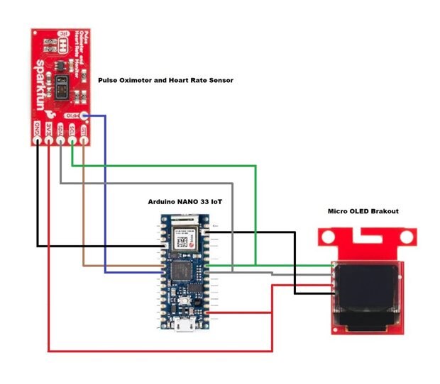

In the image below I show you the electrical diagram that we will use in this chapter.
LIST OF PARTS:
  • Arduino Nano 33 IoT Development Board
  • Pulse Oximeter and Heart Rate Sensor
  • Micro OLED Breakout
  • Lithium Ion Battery - 1Ah
HOW DOES IT WORK?
  • First, the WiFi connection is established between the Arduino NANO 33 IoT board and the Modem;
  • This sensor detects the percentage pulse oximeter (O2), and the heart rate (HR) of the finger;
  • Both values will print on the serial port and the Micro OLED Breakout screen for 10 seconds approx ;
  • Every 10 seconds the O2 and HR values will sent to the IoT server.
  • We will use the service provider IoT Ubidots, and the configuration will be seen in the next chapter.

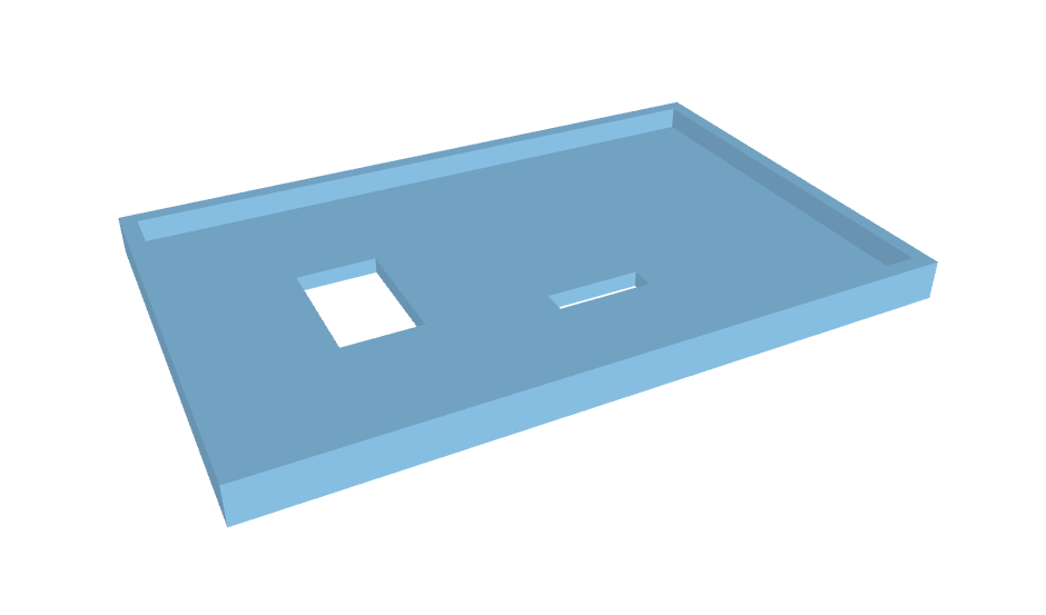

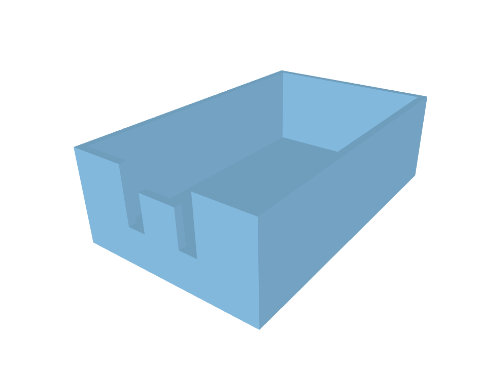

In the image below we show the box designed for this device (it's the same piece used in Blog #3).
Also, the image below shows the cover.
If you want to make a 3D impression of these designs, you can download the STL files here:  health_monitoring_box.rar

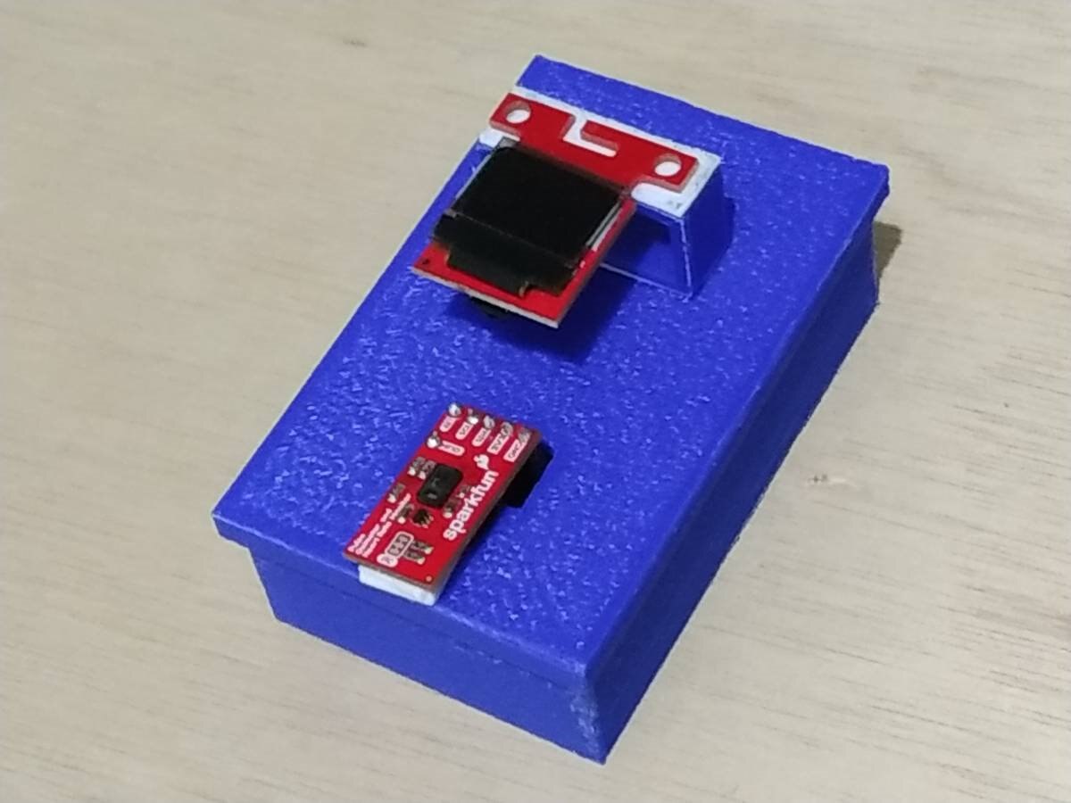

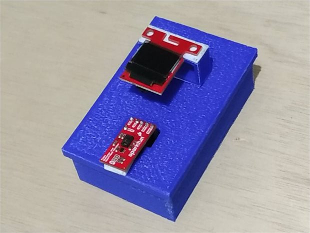

The image below shows the assembled project.
