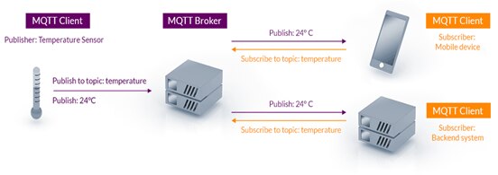

This project will be demonstrated to how the report of sensor data is collected to the IoT cloud platform through MQTT service and stored on the database, in which MQTT protocol is used to communicate with each device to the broker. MQTT is a lightweight IoT messaging protocol based on the publish-subscribe model (https://www.emqx.io/mqtt).
It is designed as an extremely lightweight publish/subscribe messaging transport that is ideal for connecting remote devices with a small code footprint and minimal network bandwidth (https://mqtt.org/).

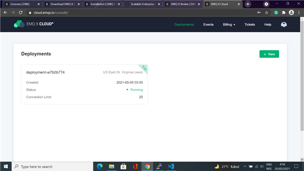

  4. EMQ X Cloud https://cloud.emqx.io/

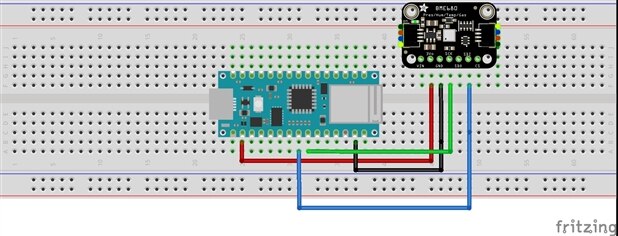

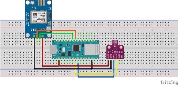

Arduino Nano 33 IoT Connection Diagram
The wiring diagram of the electronic system consists of Arduino Nano 33 IoT, Internal IMU sensor, and external BME680 sensor to collect the data which is then sent to the IoT cloud services. First, we will import WiFiNINA https://www.arduino.cc/en/Reference/WiFiNINA  and PubsubClient https://github.com/knolleary/pubsubclient  libraries. WiFiNINA can connect the Arduino Nano 33 IoT to the WiFi network, and the PubSubClient library allows us to connect to the MQTT broker and publish/subscribe to topics.

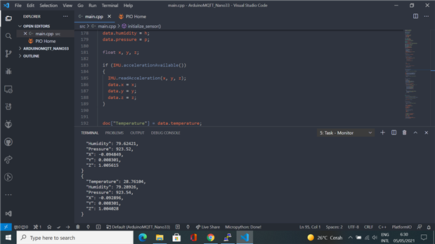

  float x, y, z;
  if (IMU.accelerationAvailable())
    IMU.readAcceleration(x, y, z);
    data.x = x;
    data.y = y;
    data.z = z;

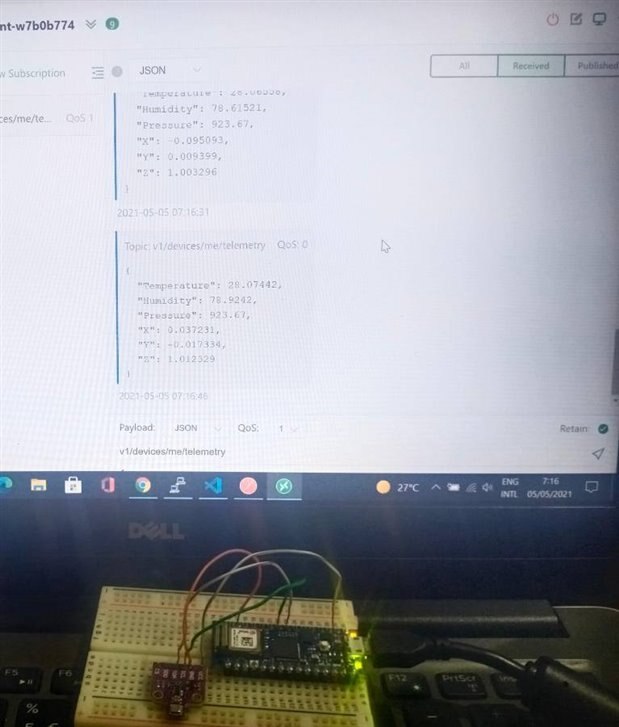

  doc["Temperature"] = data.temperature;
  doc["Humidity"] = data.humidity;
  doc["Pressure"] = data.pressure;
  doc["X"] = data.x;
  doc["Y"] = data.y;
  doc["Z"] = data.z;
  serializeJsonPretty(doc, payload);
  mqttClient.publish(publish_topic, payload);
  Serial.println(payload);
We can use the ArduinoJson library (https://arduinojson.org/ ) for packet data format to send all data sensors to the cloud.

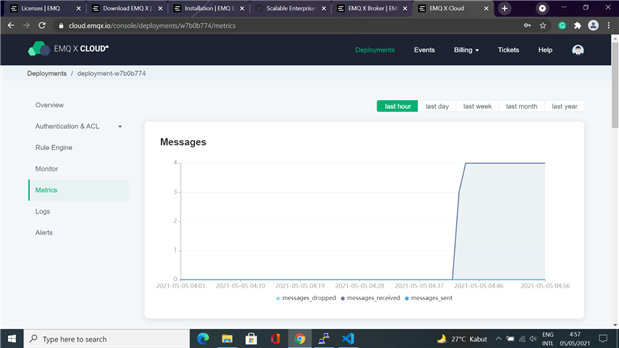

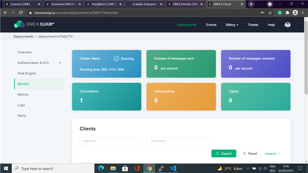

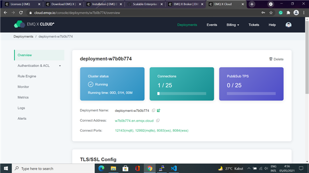

EMQ X Cloud is the MQTT IoT Cloud Service Platform launched by EMQ, which provides the MQTT 5.0 access service with one-stop operations and maintenance managed and unique isolation environment.
To visualize all data published to the MQTT broker, we could use https://mqttx.app/.

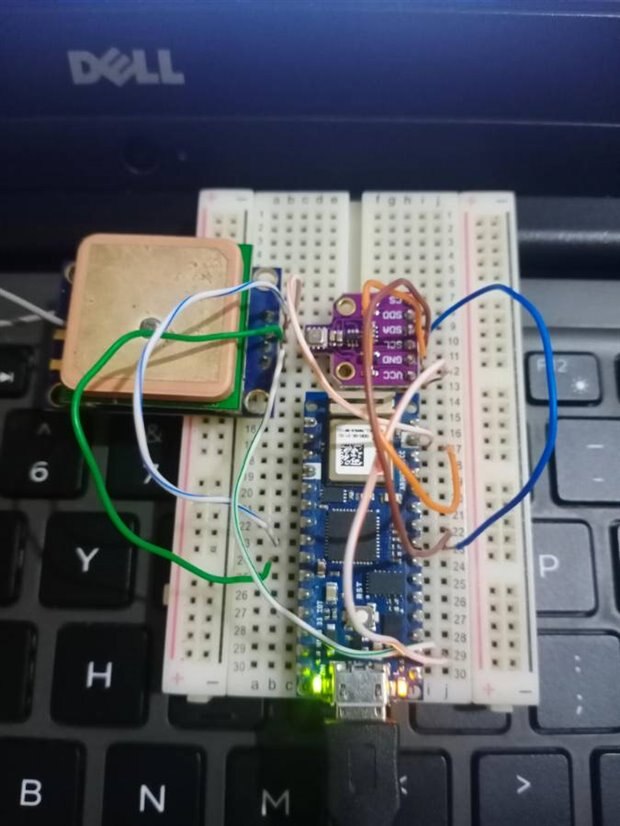

GPS Tracking System:
Overall, the part of the design is integrated system of Arduino Nano 33 IoT for data acquisition dan GPS for tracking location, MEMS sensor for environmental monitoring, and internal IMU sensor as accelerometer and gyroscope. We can import this library https://github.com/mikalhart/TinyGPSPlus to read GPS data.
We could find all source code: https://github.com/radhyahmad/Nano33IoT_Ublox_Neo-7N
So far, we have successfully implemented remote monitoring of landslide and environment use-cases using Arduino Nano 33 IoT and a free public MQTT broker. This project only describes a simple scenario for collecting data related to landslides and environmental conditions. For real implementation, we could deploy it by using Arduino MKR WAN  as low-power devices.
