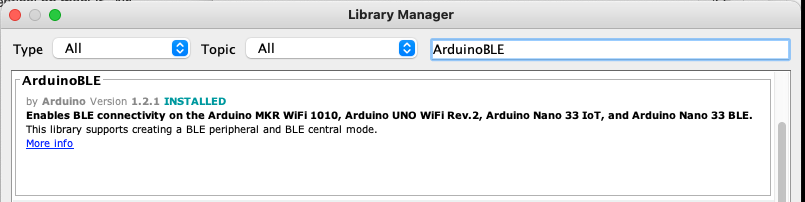

ArduinoBLE library
Arduino provides a library to interact with the BLE side of the WiFiNINA module, called "ArduinoBLE", which you can find in the Arduino Library Manager:
It comes with a few examples, like a simple example on how to control the builtin LED of the Nano 33 IoT board via BLE.

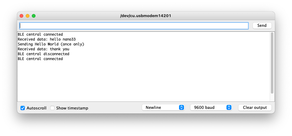

Now this is what that would look like in the Bluefruit App, and in the Arduino Serial Monitor:

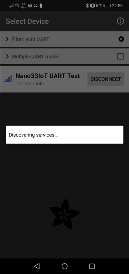

{gallery} HardwareBLESerial and the Bluefuit App
Selecting the Nano33 IoT: In the Bluefruit App, you first need to select the device to connect to. I've filtered out the UART capable devices only, so it shows just the Nano33 with my example sketch
Connecting to the Nano33: Connecting to the Nano33 IoT can take a few moments

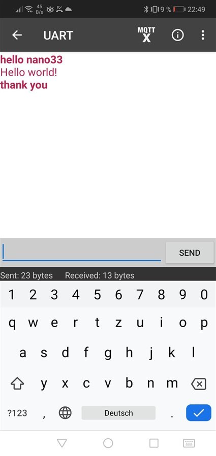

Different options to interact with the Nano33: After connecting to the Nano33 IoT, you can choose different modules to interact with the BLE device. I chose UART here.
The UART terminal: Now I can send and receive text via the UART terminal. Bold text is messages sent from the smartphone, regular text message received from the Nano33 IoT
Arduino Serial Monitor: This is what that communication looks like from the Arduino Serial Monitor
