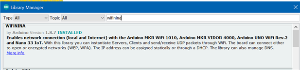

Install library
Install WiFiNINA by Arduino
Go to Library Manager to install or update the WiFiNINA library.

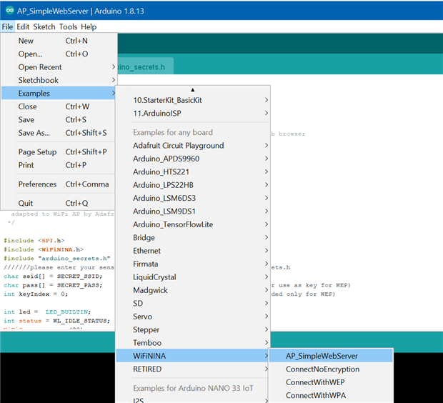

Try first this example: AP_SimpleWebServer
or download from github:
https://github.com/arduino-libraries/WiFi101/blob/master/examples/AP_SimpleWebServer/AP_SimpleWebServer.ino
That example creates a new Wifi Access Point.
Enter your sensitive data in the Secret tab/arduino_secrets.h
SECRET_SSID  is the name of your new wifi access point and SECRET_PASS the password for your new wifi access point

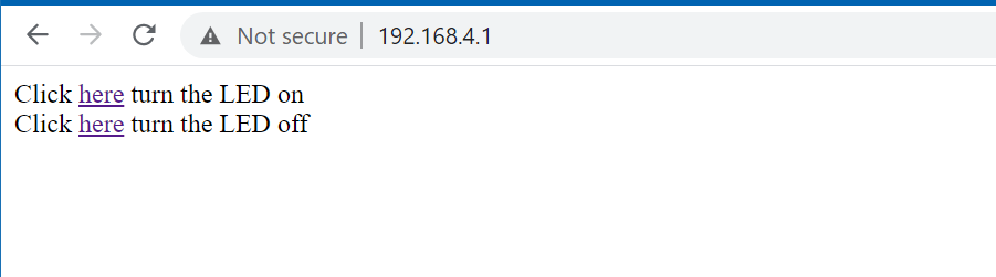

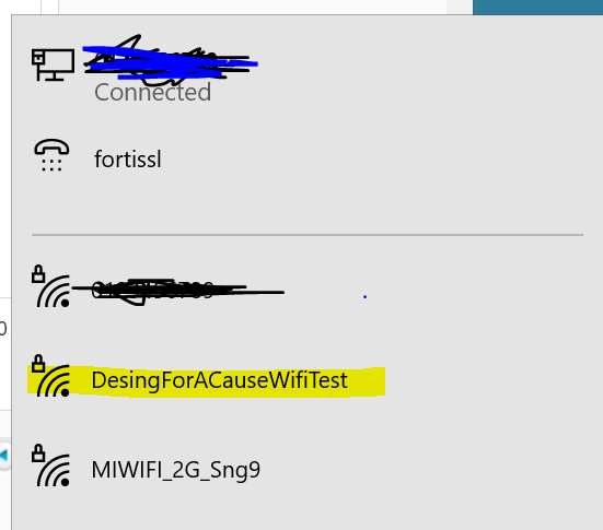

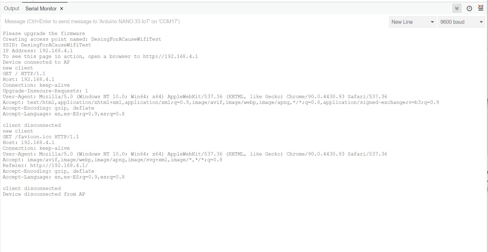

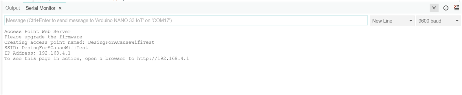

Upload the sketch an check the log in the serial port:
then from your PC or your phone connect to the new AP DesingForACauseWifiTest
Connect, enter the password and then you can access the server from a browser
You can see the log in the Serial Monitor
If you see: "PLease upgrade the firmware" your module has an old version of the firmaware.

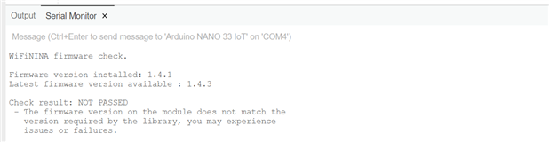

Checking wifinina firmware version
You can run version checker alternatively.
Checks if the firmware loaded on the NINA module is updated.
Open the sketch by going to File -> Examples -> WiFiNINA -> Tools -> CheckFirmwareVersion
If the sketch doesn't work try this version I modified for the Arduino Nano 33 IoT

  String fv = WiFi.firmwareVersion();
  String latestFv;
  Serial.print("Firmware version installed: ");
  Serial.println(fv);
  latestFv = WIFI_FIRMWARE_LATEST_VERSION;
  // Print required firmware version
  Serial.print("Latest firmware version available : ");
  Serial.println(latestFv);
  // Check if the latest version is installed
  Serial.println();
  if (fv >= latestFv) {
    Serial.println("Check result: PASSED");
  } else {
    Serial.println("Check result: NOT PASSED");
    Serial.println(" - The firmware version on the module does not match the");
    Serial.println("   version required by the library, you may experience");
    Serial.println("   issues or failures.");
void loop() {
  // do nothing
We need to update the wifinina firmware

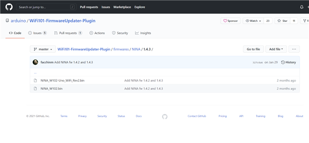

More info: https://www.arduino.cc/en/Tutorial/WiFiNINA-FirmwareUpdater

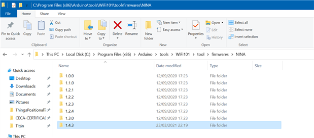

There is no option in Arduino IDE 2.0.0-beta.3 back to Arduino 1.8.13
Download the last version and copy it to firmwares directory
https://github.com/arduino/WiFi101-FirmwareUpdater-Plugin
For Windows 10:
Copy folder to

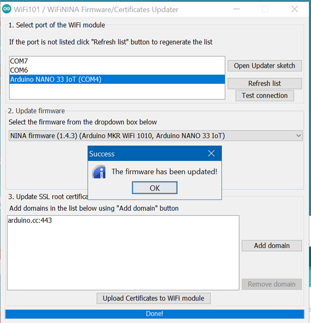

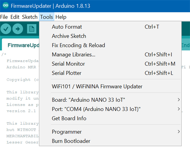

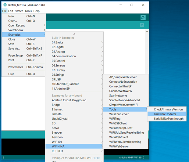

Plug in the board into your computer if you haven't done it yet and from the Tools menu select "Arduino Nano 33 IoT" as a board and select the right COM Port. Next open the FirmwareUpdater sketch by going to File -> Examples -> WiFiNINA -> Tools -> FirmwareUpdater.
Upload the sketch onto your Arduino Nano 33 IoT and close the Serial Monitor if it is open. Now launch the "WiFi 101 / NINA Firmware Updater" from the Tools menu of the IDE.
Use the Arduino IDE to upload the firmware

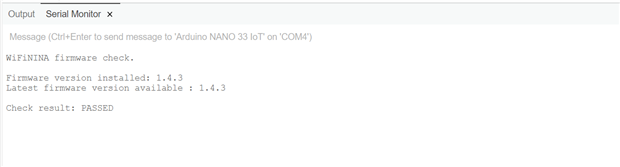

Final check of the firmware version
After the installation you can check if you have installed the latest version of the firmware by uploading the CheckFirmwareVersion sketch onto your board. You can find this sketch by going to File -> Examples -> WiFiNINA -> Tools -> CheckFirmwareVersion.
