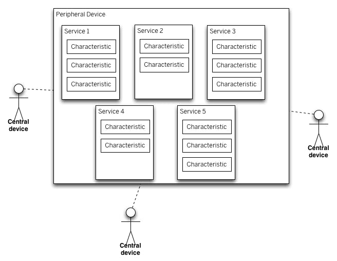

Software implementation of standard Bluetooth and Bluetooth Low Energy technology is very different. From a programming point of view the Bluetooth library has calls to find the needed Bluetooth device and writes in its stream whatever the developer wants. BLE is much more rigid. It introduces Services, and different types of Characteristics, all identified by guids. For a short description of BLE hierarchy see this image
For an explanation - this page Arduino Nano 33 Sense | BLE Battery Level Tutorial
As far as I know there is no way for them to understand each other.

I assumed I can use BLEStringCharacteristic and pass my whole command into one characteristic. However I found a limitation on the Arduino side - the limit for MTU (Maximum Transmission Unit) is 23 bytes and there is no way to change it. This makes the maximum length of my command string only 20 bytes. It is not enough, my command string should be about 90 bytes. So I had to make several characteristics, for 4 groups of parameters. And to make each command string less descriptive but shorter. It is not the approach I wanted but I believe is is better than creating 12 different characteristics for each parameter. (And as I mentioned before, parameters are not independent)
This approach is working so far but I am not nearly done.
