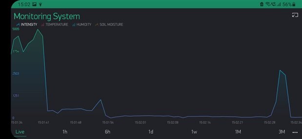

Measuring intensity of light using LDR:
We read analog value given by LDR using A0 pin. It gives a value between 0 - 1023.
The resistance of the Light Dependent Resistor (LDR) varies according to the amount of light that falls on it. The relationship between the resistance RL and light intensity Lux for a typical LDR is
Therefore, to calculate the intensity in lux, we use this formula
lux = (500*1024 / LDRvalue) - 500;

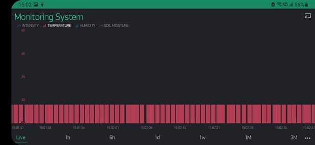

Measuring Temperature and Humidity using DHT 11:
For using DHT 11, we use EduIntro.h library.
I simply defined the DHT 11 pin as D7
DHT11 dht11(D7);  // creating the object sensor on pin 'D7'
Then, we can simply call these functions to get temperature and humidity
dht11.update();  //this meant to start the sensor
dht11.readCelsius();
dht11.readHumidity();

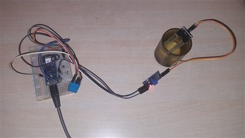

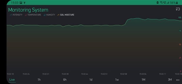

Measuring Soil Moisture using soil sensor:
Using the soil sensor works in a similar way like the LDR. It measures resistance to calculate moisture content. Higher resistance means less moisture.
So, we need to convert the analog value given by sensor(in between 0 - 1023) to moisture percentage.
I wrote this snippet of the code to do this.
I added 35 to account for resistance which was there even in 100% water.
  //calculating moisture percentage using analog value of the sensor
  moisture_value = analogRead(soil_pin);
  //converting to percentage
  moisture_value = (moisture_value * 100) / 1023;
  //using formula to account for resistance
  moisture_value = 35 + (100 - moisture_value);

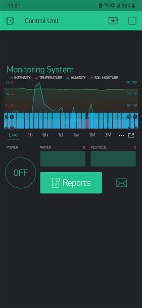

Communicating to Blynk App:
We can simply define Virtual Pins to send data to Blynk App and use these lines of code. The rest of the setup needs to be done in the App.
//sending all values to the Blynk App using Virtual Pins
  Blynk.virtualWrite(V5, lux);
  Blynk.virtualWrite(V6, dht11.readCelsius());
  Blynk.virtualWrite(V7, dht11.readHumidity());
  Blynk.virtualWrite(V8, moisture_value);
Blynk App:

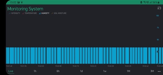

I used SuperChart widget for the monitoring system. It can plot data for 4 data streams which was enough for this task.
Remember to setup in the Super Chart widget:
  • V5 - Intensity
  • V6 - Temperature
  • V7 - Humidity
  • V8 - Moisture
Rest of the work is done automatically by Blynk. We just need to upload the code and wire the connections. Power up the Arduino Nano 33 IOT and run the App to see the charts.

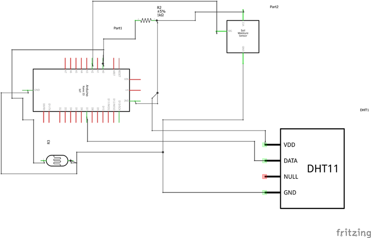

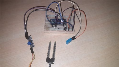

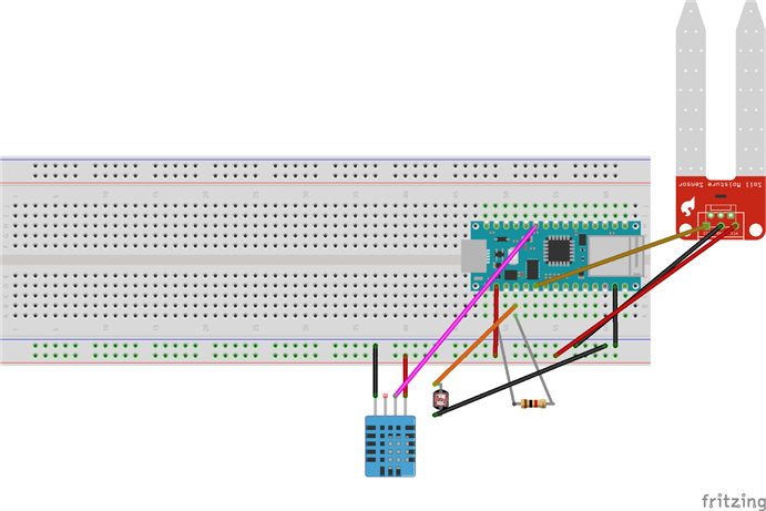

Wiring:
Breadboard:
Schematic:

Blynk App
Humidity Graph
Temperature Graph
Soil Moisture Graph
Light Intensity Graph
