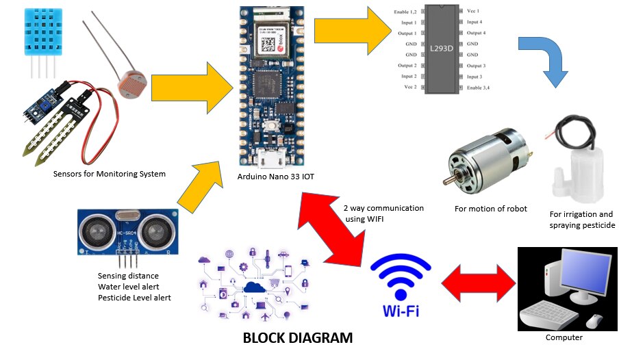

This project is based on the Arduino Nano 33 IOT which allows the farmer to track real time data and communicate with the robot over the internet.

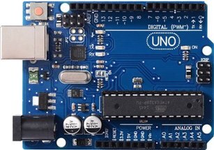

9. Arduino Uno R3
This will be used to control the motors for automatic movement of the bot.
Arduino Uno is a microcontroller board based on the ATmega328P

Project Flowchart
