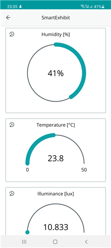

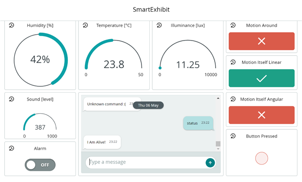

  • I designed a Dashboard in the Arduino IoT Cloud for:
    • visualizing the received values from the hardware platform
    • chatting in a basic way with the hardware platform image If the "status" message is written from the  and if the hardware platform is functioning normally, the message "I Am Alive!" will be received. If any other message is sent, the response will be "Unknown command : ("
    • manually switching on an alarm from the hardware platform (a beeping using the speaker). For example, if a too high temperature value is seen on the Dashboard, the Museum staff can trigger the alarm because probably a fire appeared close to the exhibit and protection measures should be taken.
  • Here is how the Dashboard looks in action on a computer:
  • Here is how the Dashboard looks in action on a phone (partially, because some scrolling is needed image) using the Arduino IoT Cloud Remote Android app:
