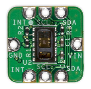

The MAX30102 has an on-chip temperature sensor for
calibrating the temperature dependence of the SpO2 subsystem.
The temperature sensor has an inherent resolution
of 0.0625°C.
I would like to use it for body temperature detection. But it seemed to be slow. Temperature rises up to around 34'C but it does not rise up or get down rapidly. However, that will be fine as the body temperature does not change too fast.

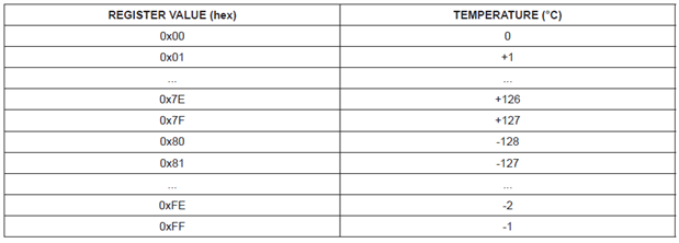

Temperature Data (0x1F–0x21)
Temperature Integer
The on-board temperature ADC output is split into two registers, one to store the integer temperature and one to store the fraction. Both should be read when reading the temperature data, and the equation below shows how to add the two registers together:
TMEASURED = TINTEGER + TFRACTION
This register stores the integer temperature data in 2’s complement format, where each bit corresponds to 1°C.

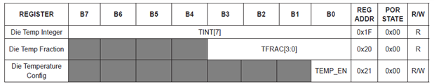

Temperature Fraction
This register stores the fractional temperature data in increments of 0.0625°C.

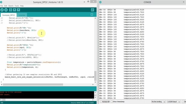

Output:
{gallery} Max30102 Temperature
Serial Terminal: MAX30102 gives RED and IR PPG and temperature value. NANO 33 IOT calculates the Heart Rate and SpO2. serial terminal shows these output along with Temperature.

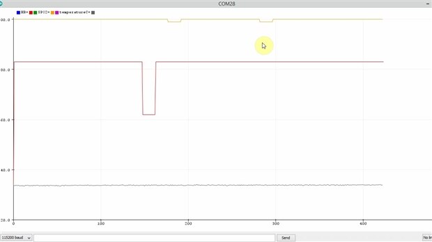

Plotting output: Heart Rate, SpO2 and Temperature are plotted together for the time being.
